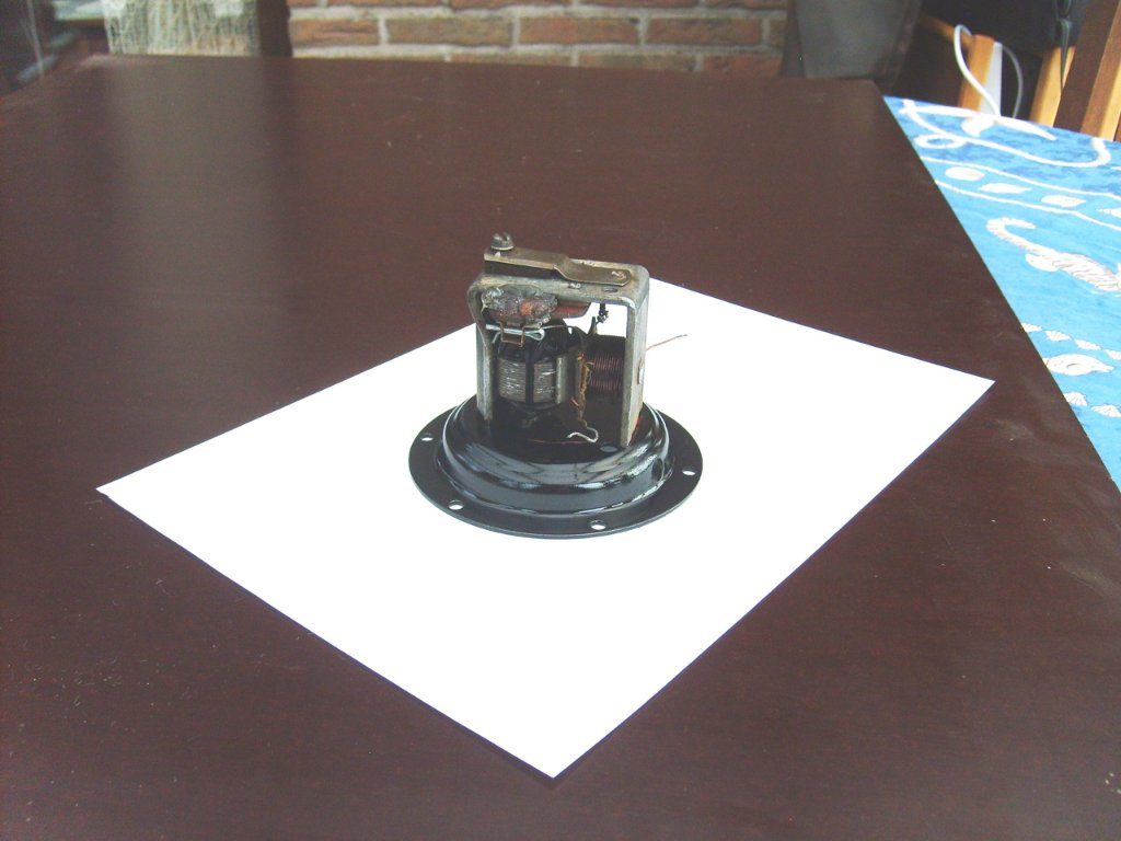

Which battery horn is this on my 24 T?
Post by 24TFORDOR » Wed Mar 08, 2023 2:31 am
Looking for a replacement cover for this battery horn in my 1924 Fordor. Is it a klaxon horn and is it 6V or 12V? The previous owner stuck a 12v battery in the car and this blew every light bulb in thr car. Will running the horn on 12v also burn it out or is it safe on 12v? The horn makes the ahooga sound, but it’s sickly sounding and probably needs a rebuild or adjustment. Any guidance would be appreciated.

Not T, nor A. A has a flared trumpet.

That's a Klaxon-type horn. I don't know what it came from. It looks very old, and is almost certainly a 6 volt device. It may be an aftermarket item. Running 6 volt equipment on 12 volts will destroy it.* A Model T is supposed to be 6 volt negative ground.

On the horn, the cover is held on with 1 small bolt at the bracket holding the windings. All you probably have to do to get it working correctly is clean (spray electrical cleaner) the brush dust off the contacts, make sure brush’s are free moving and a little 3n1 oil. Don’t be liberal with the oil. Don’t laugh but you can use a soup can or veggie can to make a cover. If you want to be Avant garde, get a can with ridges if not a smooth side can will work too. The trick is not being watched to closely when you take your small tape measure into the store and going down the canned food isle measuring OD & length. Depending on what your car looks like or your humor level, you may choose to leave the label on or take off & paint. The horn you have is much louder than the model T horn and doesn’t sound like a calf getting castrated.

The horn the OP has is a motor horn, not a vibrator horn.

There were only a few horns made back then that were 12 volt, like the North East that Dodge Brother used till about 1926 ($), so yes, I would say it is 6 volt. To use on a 12 volt system, it would work but not as it should, so you would never get the sound that would be right. It would need a voltage reducer or would need the armature rewound for 12 volts.
More than likely it needs to be cleaned, lubed and adjusted anyway. While Klaxon was a brand name, this may not have been made by them, unless there it is stamped or has a tag on it.
My suggestion would be, if you can't find and actual cover, you might try the soup can approach. Find a tin can that is the correct diameter and length (shorten if needed), drill a mounting hole in the back, paint and install. Would not be the first time that something like this has been done.

Most of those Brush horns have the brushes tied in parallel for six volts.
If you figure out the circuit, they can be hooked in series for 12 volt operation.
It has been a long time since I did the change, but that was with one of the newer 12 Volt horns sold by J. C. Whitney and it worked fine.
The acid test is to try the horn and look for smoke.

I think You have a Kaxet horn.

Thanks all, this does look like a vintage 20s Klaxon Klaxet horn! The horn works fine on 12v and makes a decent sound and I didn't notice any smoke when activating it in the garage. I guess some of these horns were originally wired for 6v and others for 12v...I don't know which one this is since the cover is missing. The brushes and magnet/winding definitely need a good cleaning and lubrication which I will take care of before installing a new cover. This guy in Australia seems to be an expert with these horns and I might reach out to him to see if he has any spare covers or brackets to make it look complete again: http://www.klaxonhorns.com/. I also found this Klaxon horn video on YouTube: https://www.youtube.com/watch?v=QiJbWB27l2g

Wanted to follow up and provide and update on my Klaxon 8c horn. I disassembled, cleaned, lubricated and adjusted the horn and now it works great, even on 12v. It does spin a little fast and doesn’t sound perfect, so I’d like to installed a resister to lower the voltage to 6v. Does anyone have a link to the correct part or instructions on how to wire that up? I also ordered another rebuilt Klaxon 8c from eBay today for $200 so I have a motor cover and a spare horn in case I need it. Can’t wait to use this ahooga horn once I get the car back on the road!
