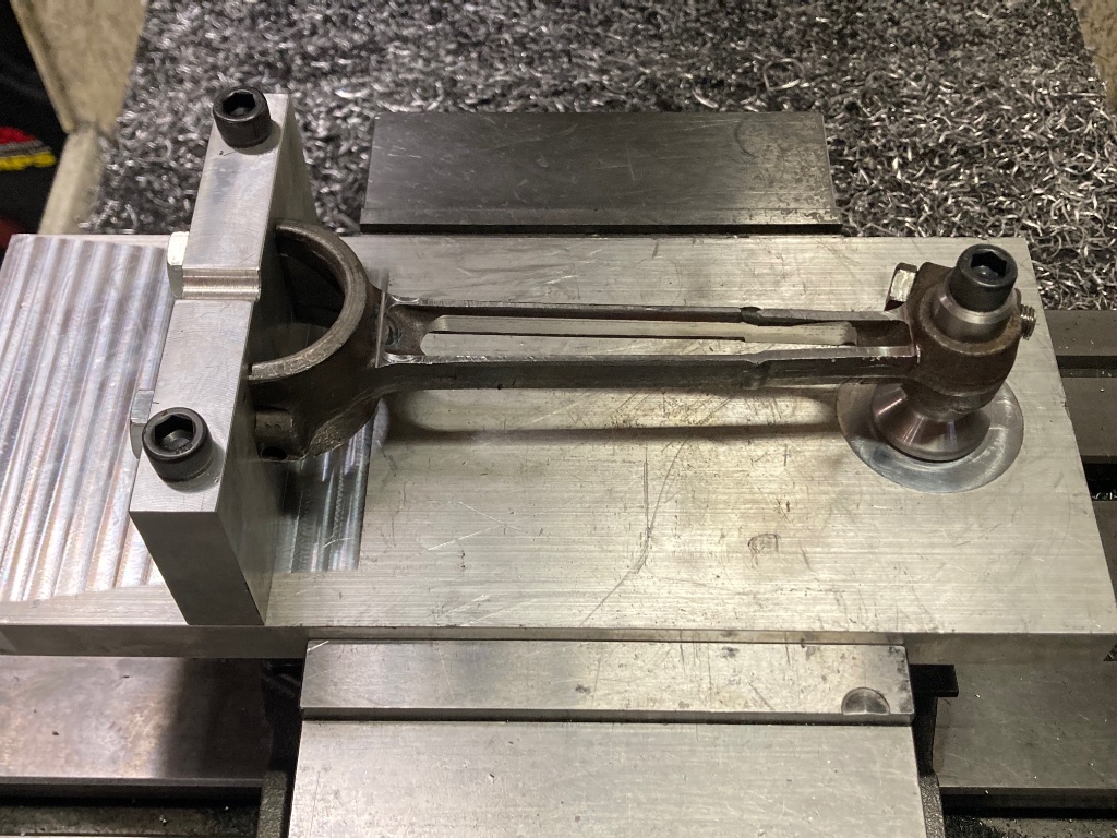

Post by Kevin Pharis » Sun Mar 12, 2023 9:49 pm
Here is a couple pics of todays progress. Apparently my old rod fixture was lost in dads recent move… so made a new fixture this morning, and started putting pieces together 👍

Kevin
I trust there’s another picture to come??(tomorrows progress)?

Post by Kevin Pharis » Sun Mar 12, 2023 11:00 pm
Not too sure bout the timeline… but this should be a fairly quick project. My dad should be cutting the other 3 rods while I’m at work tomorrow, and I may be able to get all 4 to this stage over the next couple of days. Once all are to this point, I will rough balance, then start on the boxing plates

Post by BRENT in 10-uh-C » Mon Mar 13, 2023 8:41 am
Les, I used to have a picture of a 'rod press' that was used to compact a Model-A rod. Evidently, the rod was heated and then the jig was on a sliding post where the rod was placed into a hydraulic press and then the rod was compacted to the correct length.
Kevin, I like your method of removing the section between the beams and then adding a continuous piece to make a solid beam.

Post by Kevin Pharis » Mon Mar 13, 2023 8:46 pm
The center web is removed to lighten the rod. Next I will cut 2 16ga steel “boxing” plates that will be welded to each side of the rod, creating a rectangular tube section where the I beam was. The boxing plates create a massive weld surface area compared to simply welding the I beam back together. I would be curious to see how the failed rods mentioned above were shortened, and also hear how and who welded em.

Post by Kevin Pharis » Sat Mar 18, 2023 6:32 pm
Made some progress today;
With all the rods shortened and webs removed, I V grooved the inside of the weld joint and welded from the inside. Also did a rough balancing job which required some grinding, and some adding of weight;
Next was cutting the boxing plates;
Tacking together;
And final welding;

Post by Dave1 » Sat Mar 18, 2023 7:57 pm
Looks good Kevin, why do you remove the inner web? is it a weight issue?
Dave Eddie
Kevin Pharis
Posts: 1591
First Name: Kevin
Last Name: Pharis
Location: Sacramento CA
Re: Welding connecting rods
Post by Kevin Pharis » Sat Mar 18, 2023 10:35 pm
With the center web removed, the boxed and welded rod now weighs within a few grams of what the original donor components weighed

Post by Dave1 » Sun Mar 19, 2023 1:24 pm
Any heating required, before or after welding ?
Dave Eddie
Kevin Pharis
Posts: 1591
First Name: Kevin
Last Name: Pharis
Post by Kevin Pharis » Sun Mar 19, 2023 1:49 pm
I follow typical chromoly welding practices. Preheat to above 300F and TIG weld with er70s-2 filler rod. I post heat when welding the 2 rod pieces together as the part chills pretty fast. But when welding the boxing plates, the whole part is near dull red when finished, and cools evenly in still air
I’m about 4 hours into the shortening fixture, and 8-10 hours into the machining, fitting, and welding of all 4 rods. Not a huge or complicated project, but attention to detail is important. The next step will be assembling the big end of the rods, straightening, and pre-machining for babbit. The shortening fixture references the parting seam of the rod… and the big end bores are not always where they should be

Kevin,
When are welding the boxing plates to the rod, do you secure the rod in the alignment fixture to minimize warping.
Dave
Kevin Pharis
Posts: 1591
First Name: Kevin
Last Name: Pharis
Post by Kevin Pharis » Fri Dec 27, 2024 12:06 pm
Nope. The fixture will not allow access to all sides when welding. You will need to evenly preheat, tack weld both plates approximately 3/4” spacing, then weld all around in balanced segments. I found that welding 1 rod complete is very hot when finished. To the point where controlling the weld puddle can be challenging. Take a couple minutes between the later weld segments to allow heat to dissipate as the rod gets too hot
The rod will need to be straightened no matter what. Do your best to balance heat and the rod won’t warp much
