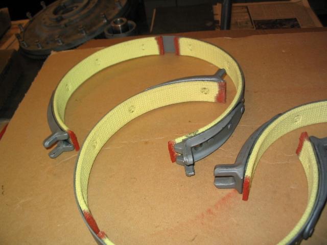

- Posts: 4961
Re: Short transmission bands installation
I have used this method with no known issues on other motors out in the wild.
The shorter scandia band require a pretty wide gap @ the bottom to get good cover under the top ends.
More gap than I would prefer. More gap than pictured here with the kevlar bands.
I think a little stretch rolling coupled with a smaller gap, say 3/8", would be ideal.
