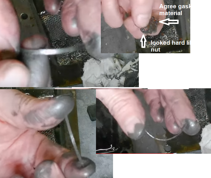

I posted this in the "other" discussion ion the same issueTheSpeedsterProject wrote: ↑Wed Mar 22, 2023 9:04 pm......................
I had the inspection cover open recently (filmed that too - oil change video), didn't see anything wrong. It still rolls free ................
You'd better ID what you found in the oil screen and drop the the inspection pan to see if there is more of that!

Only You know what You put in this motor You rebuilt. Do confess, so no one else makes a similar mistake.
Thats some nasty goo.
Root canal time!
I wouldnt do any less than than a complete disassembly & cleaning. (including oil control rings)
That goo looks thick enough to plug & restrict any & all internal oil entry points.
Root canal time!
- Posts: 5251
Re: Requesting "Think tank"
Tripple gear bushings are prone to locking up, so extra clearance is a good idea during a rebuild.
Even with extra clearance, they cant be run dry.
That goo will not lube those bushings or the drum bushings either for that matter.
Lurching problem solved.
I hope you will be able to disassemble the transmission without destroying it.
There is bound to be some galling @ the least.

Doesn't that goo look like anti-seize, they way it sticks to fingers etcspeedytinc wrote: ↑Thu Mar 23, 2023 1:59 pmTripple gear bushings are prone to locking up, so extra clearance is a good idea during a rebuild.
- Posts: 5251
It does, but, Why would there be 2 tubes worth in a motor??TRDxB2 wrote: ↑Thu Mar 23, 2023 2:12 pmDoesn't that goo look like anti-seize, they way it sticks to fingers etcspeedytinc wrote: ↑Thu Mar 23, 2023 1:59 pmTripple gear bushings are prone to locking up, so extra clearance is a good idea during a rebuild.
The grey color is commonly indicative of iron shavings from the cylinders. Chrome molly rings? or just the lack of lubrication.
Some is expected to be caught on the transmission screen magnet in a new motor, but decreases to negligible over time.
