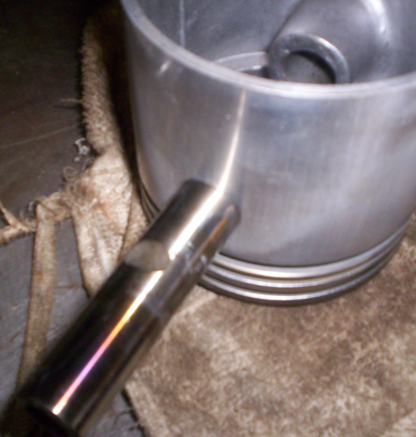

Hi All,
Well I am slowly progressing, crank is now good as are the con rods all at 1.5 thou clearance with no binding. They were a pig to balance, I ended up doing twenty measurements and averaging…
So I thought I would check my pistons. These are new cam ground 0.20 oversize. I told the machine shop that bored the block to go with 0.0035 clearance minimum. They protested as the box said 0.002-0.003, I quoted this forum and that really I should run 0.004. They said they would do 0.0035 minimum.
I am not sure they did, but I may be measuring wrong. So I am measuring at 90 degrees to pin as below. Feeler gauges are metric but correspond to very very tight 0.002 at base of piston in first photo and about 0.0035 at mid point in second photo just under wrist pin (90 degrees to wrist pin but at just below height of wrist pin). I am assuming it is too tight, if so I am buying hone and fixing it myself. However what do you all think?

.002 is too tight. I like .0045-.005" Even .006", I would rather hear a little piston slap until the motor warms up than risk seizing.
Modern honing machines can be set for an exact amount of removal & stay perfectly parallel.
Doing the job by hand isnt so easy in both regards. An accurate cylinder bore gauge would be handy to check your work as you go.
If possible, take the block back & have em do it right.
Also check wrist pin fit. They are typically too tight. The pin should just fall out on its own weight when tilted on its side.

I have just checked all 4 pistons in all 4 holes and they all measure the same. So in-line with the pin about 11-12 thou at base. 90 degrees to pin at base, less than 2 thou. At the level of pin, but 90 degrees to it is 3.5 thou or so.
I had assumed that the taper of the piston continues to the base? So the advice on 4 or 5 thou clearance, is that at the pin level and ignore the very tight base of skirt? Or should it be minimum of 4 thou at base of skirt?
I have been through the pins polishing them and they all now slide out effortlessly, which is really annoying when you take the piston out the box and forget to hold the pin…
If I do hone, I suppose I am starting from a good straight bore and would only be taking a thou or so.

The clearance is @ the maximum diameter of the piston skirt. Too tight.
Dont assume the bores are straight. VERIFY, VERIFY, VERIFY. Your shop already didnt follow your direction.
They should have known that .002 is to tight. Modern piston clearances in this bore size would be .001" per inch. .00375 here. At least they were 40 years ago.
I would want a bore gauge to confirm accuracy.

Check your wrist pins too. Most need a little honing cause they are too tight and will lock up.

Hi all,
Well I called another machine shop that had straightened the con rods for me and took the block and pistons to them. They do lots of vintage stuff including stuff for vintage racing and such. Anyway I said I thought I only had two thou based on my crude measurement with feeler gauges. Well they measured everything right there and then with a very fancy new bore gauge and mic and after several minutes said that I have… 2 thou clearance…
So I left the block with them and they will hone it out to a max of 4.5. I settled on that figure based on the fact that they have new accurate gear, understand the need for more clearance and I will have a newly cored rad and I took the core plugs out and pressure washed the water ways in the head. I have also made sure my pins are good, I polished the holes using autosol and the pins slide out under their own weight. Finally my car is a speedster so will not be lugging around loads of weight under load.
I am also getting them to skim the deck as it did have a bit of unevenness and I noticed the threads are pulling a bit on the head. The head bolts look a bit stretched, so when I get it back, I am going to chase threads, soak the holes in brake cleaner, blast them out with compressed air and then use new bolts.
This car is driving me crazy though, everything seems to just turn into a mini nightmare and every time I buy something or get machining done, it goes wrong in some way; the new bent Scat crank was just one small episode in a list of silly problems. I must have really done something bad in a previous life… However I am winning slowly one battle at a time and hopefully by June it will be running.

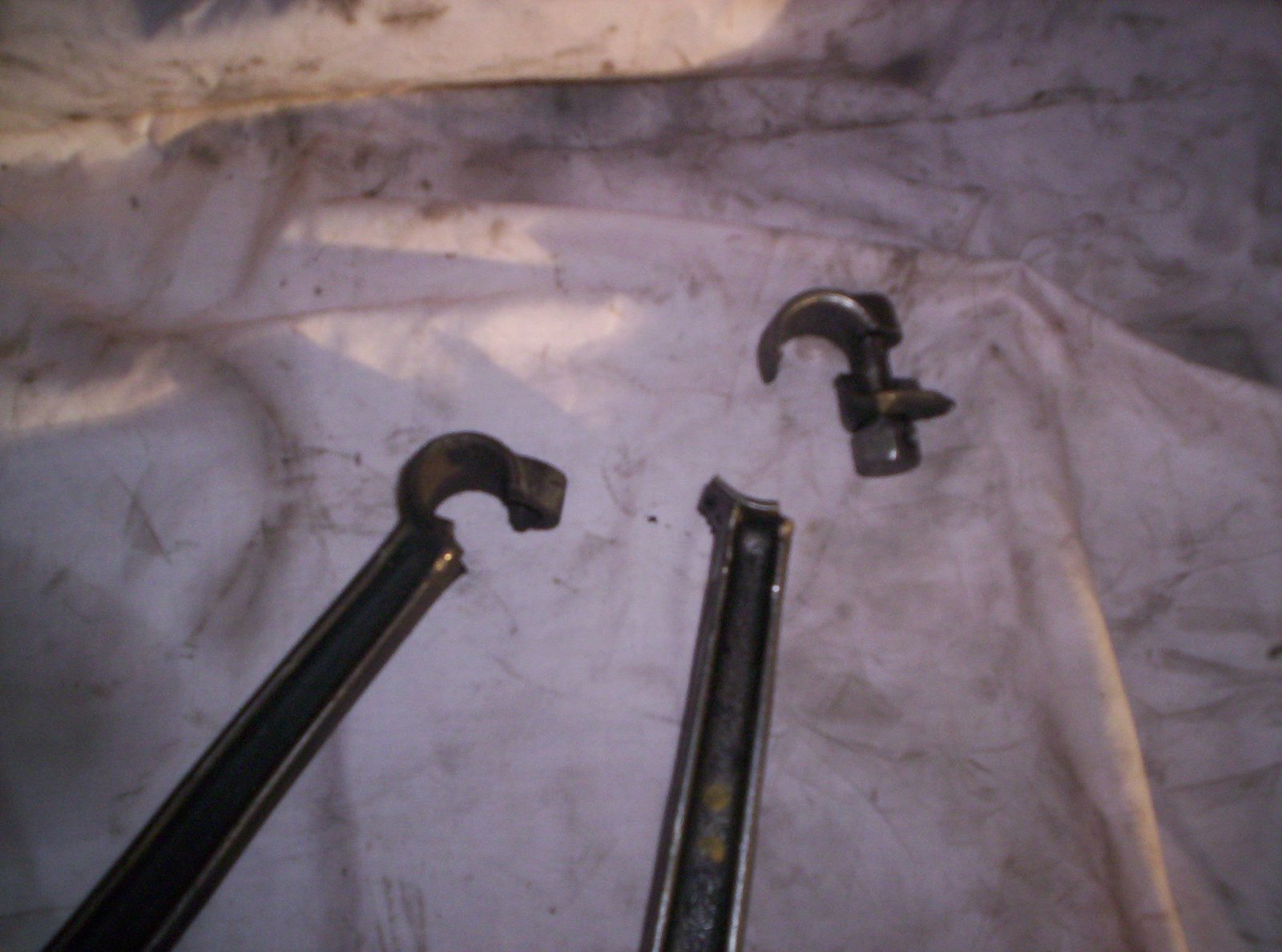

Another area that needs to be looked at when assembling an engine is the amount of connecting rod clamp force on the wrist pin. If it is excessive it can cause the wrist pin to warp and bind the pin to the piston. I have seen that happen with large engines with 1inch wrist pins and with Model T wrist pins that have turned blue.

Art, I've been re-building T engines for ever, the only time I've seen pins turn blue is when a piston has no oil hole for them.

I have seen a wrist pin that seized because of the hole in the rod being nasty rough. (oil holes present in the wrist pin bosses) Tightening the clamp bolt distorted the pin enough to egg & tighten a proper fitting pin into a now tight fit in the piston. Honing the rod hole is sometimes necessary, but a good practice always. After tightening the clamp, check that the pin still moves as freely as before clamping. Lots of mine fields & tricks to know about.Art Wilson wrote: ↑Thu May 30, 2024 7:56 pmAnother area that needs to be looked at when assembling an engine is the amount of connecting rod clamp force on the wrist pin. If it is excessive it can cause the wrist pin to warp and bind the pin to the piston. I have seen that happen with large engines with 1inch wrist pins and with Model T wrist pins that have turned blue.

I know it is a bit of a drift from the original topic but while on the pins the biggest problem is those who fit the rods the wrong way around, now that's a time bomb waiting to happen.
