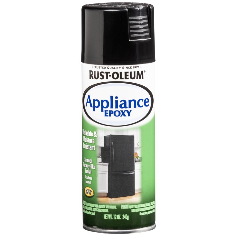

Original is, by far, the best. After a refurbishment it will be as good as new and way better than a repro. I think you had a thread about this several months back. When reassembled, prime and paint gloss black. Rustoleum Appliance Epoxy is the best. Might want to look it up and review it to see what was said back then. Jim Patrick
