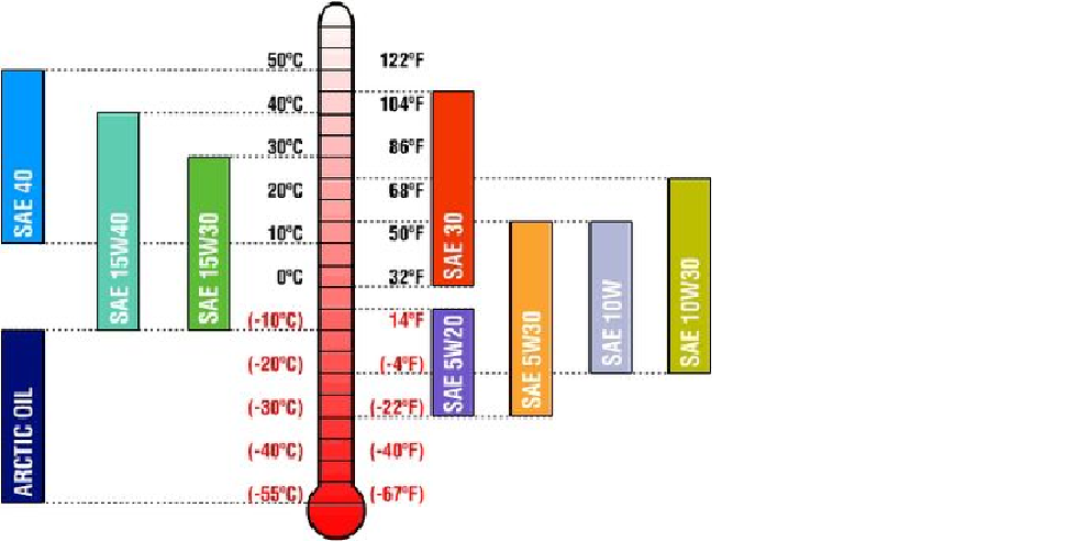

Engine oil selection opinions are likely based on what outside temperatures people plan to drive in. The chart below shows various weights on the left & right side of the temperature gauge. For mult-grade oils the first number applies to cold starting and the second to a running engine. There are many other viscosities available. 30W may be good for most but something like 5W40 would be better for easier cranking/starting and just as good when hot. I couldn't find a comprehensive chart for most grades applied to degrees Fahrenheit only Centigrade temperatures. Detergent vs Non-Detergent stick with whatever you have been using. Here is a link on Synthetic vs Detergent oils https://www.gotodobbs.com/blog/syntheti ... ional-oil/

Post by Hal » Mon May 13, 2019 7:23 am
Unfortunately, even those charts can be found with temperatures for the same oil all over the board. That one is especially suspect as my modern car says to use 5W20 PERIOD, and didn't bother to ask what the temperature was where I live, but according to that chart if it's above 14*F I shouldn't use it.
