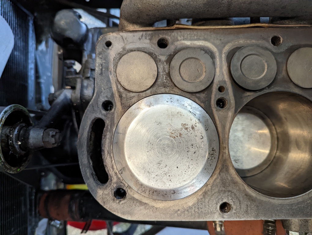

Have you looked very carefully for any evidence of piston scuffing or scoring? Check both the upper and lower bores. The lower edge of the piston skirt in the second picture looks odd. Is that oil?

The pistons appear to be a good tight fit in the bores, which is good. However, the overheating incident last August could have led to some scuffing or light scoring of one or more pistons, which could cause a sound like that.
A Z head would certainly raise compression, but it's still very low for an engine running on 87 octane gas, and at idle or anywhere near it, the effective compression is very low due to the throttle being nearly closed and thus the intake manifold pressure and actual compression pressure being very low.
From here, it sounds to me like a mechanical issue, probably a minor one.

Some very light lines, I couldn't catch my fingernail on any of them. Everything felt smooth mostly.

Do I need to worry much? Can I drive it like this?TXGOAT2 wrote: ↑Thu Apr 06, 2023 7:57 pmThe pistons appear to be a good tight fit in the bores, which is good. However, the overheating incident last August could have led to some scuffing or light scoring of one or more pistons, which could cause a sound like that.

"Overheated last August after the radiator failed so I had the head off again to clean and inspect. Some photos attached. The sound seems new to me, but I’m not really sure." (Etc.)
Did you try cranking the engine by hand when you had the head off? It should turn very easily with no uneven friction or drag, and most of that friction/drag should be from the clutch.
No one can tell you with certainty whether the engine is or is not safe to run by listening to a recording.
At best, you'll get educated guesses.
A person with substantial mechanical experience who is familiar with Model Ts could give you a much better opinion of your engine's condition if that person could examine the vehicle in person. Such an examination would consist of starting the engine cold and observing it while it warms up, then taking the vehicle out on the road for half an hour or so, then observing it some more.
Following that, an informed opinion of what might be wrong, if anything, can be offered, and an informed opinion of how serious an issue it is can be offered.
RE: "Overheated last August after the radiator failed so I had the head off again to clean and inspect. Some photos attached. The sound seems new to me, but I’m not really sure." .............
I'd want to make absolutely certain that no piston scuffing/scoring resulted from this incident.
A simple boilover isn't likely to have caused trouble, unless the aluminum pistons were fit very tightly, which they appear to be, or unless for any reason lubrication was less than ideal.

Check for evidence of stuck/stiff wrist pins whall you are there.
Thats been an ongoing overlooked issue.
Regarding "can I keep running it?" NO, not advisable, UNTIL you know what the noise is. If it were determined to be timing gear noise, for example. OK to run. If it loose or pounded rod bearings, obviously no.

..... "Check for evidence of stuck/stiff wrist pins whall you are there.
Thats been an ongoing overlooked issue.".....
I don't see any oil holes in the piston pin bosses.

When installing such a head, the procedure is to put in place with bolts loose in the block with no head gasket for line up. Bolts allow at least 1/4" rise in the head. Push the head to the left & hand crank. Watch for ony movement. Repeat this test pushing the head to the right, front & rear.
This way you confirm nothing internally will hit. You can install the head gasket.
You can paint the valve pocket/combustion chambers also. Any upset in the paint but no head movement indicates a close situation. Trim tight spots as needed.
My experience with past Z heads is the combustion chambers vary wildly.

Jason - I had the same knocking sound start on my 1919 after running the engine a few years after a rebuild. Upon inspection, I found babbitt missing on the #4 rod and cap (see photos). Although I have a three-dip pan, after removing the head, I was able to make repairs through the inspection plate. It was a tight squeeze and I had to get a little creative even with small hands, but it can be done. Been runnning well ever since.
