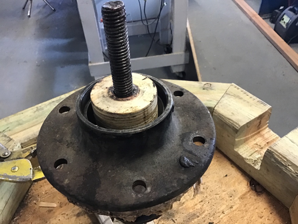

All the pictures & videos I’ve seen show the hubs being pressed with no seals in them. My hubs have new bearings, races, & seals installed. Is there any reason I can’t press these hubs with the inner bearings & seals in place ?

Harvey, one of the few perceived weaknesses of the Regan Press is the fact that it requires more care on hub alignment than I think some folks realize. The most successful jobs and the best advice will always involve some sort of upper and lower alignment guides which keep things square to the spokes...in my personal case, I have upper and lower pilots. One set of pilots is for a hub with no bearing races installed, and one set is for hubs that have bearing races installed (I'd rather know the hub/race fit is good BEFORE I marry it to spokes!). What I would NOT want to do is press the wheel together using the roller bearing as the "push" part. I would personally be inclined to sacrifice the new seal and remove the roller right now rather than risk damage to either the roller or race. It is very good that you mentioned this prior to starting and now you have the info to make a decision which is right for you. It takes a LOT of force applied to the hub to start the "teepee" of spokes to nest together correctly and the highest forces occur just past the point where you would estimate that things are 3/4 of the way pressed home. Soap or beeswax on the tenons can be helpful and do not be tempted to reduce the diameter of the tenons...they are supposed to be larger than the holes in the felloes and re-swell to size after pressed through.

I would not do it with the bearings in place. The races should be fine. It is not hard to install the inner bearings. Just make sure there is no way that your equipment might damage the races.

Re: Ready to build my wheels. Any tips, tricks, or things a should be careful of?
Scott,
You are right in making bushings to push on the races and I have access to a turning lathe to make them. That way I should have zero trouble with keeling the hubs centered & with a little patience, I should get great results. Thank you!
Harvey
Harvey
- Posts: 6596
harvey, when you make it, you want it to push on the edge/end of the race and have a diameter very close to the ID of the hub...you do not want to be pushing on the taper/bearing face of the race as that will possibly damage the surface finish and transfer lots of force outward rather than downward...I bet you see what I'm getting at
Scott,
I clearly understand what you are saying. Today I will take a spare hub to a shop & make bushings to fit both the inner & outer races. With that the hub stays centered nicely. Also will not hold the felloe in place with bolts as it will center itself when pressing. I think I’m on the right track now.
Harvey
