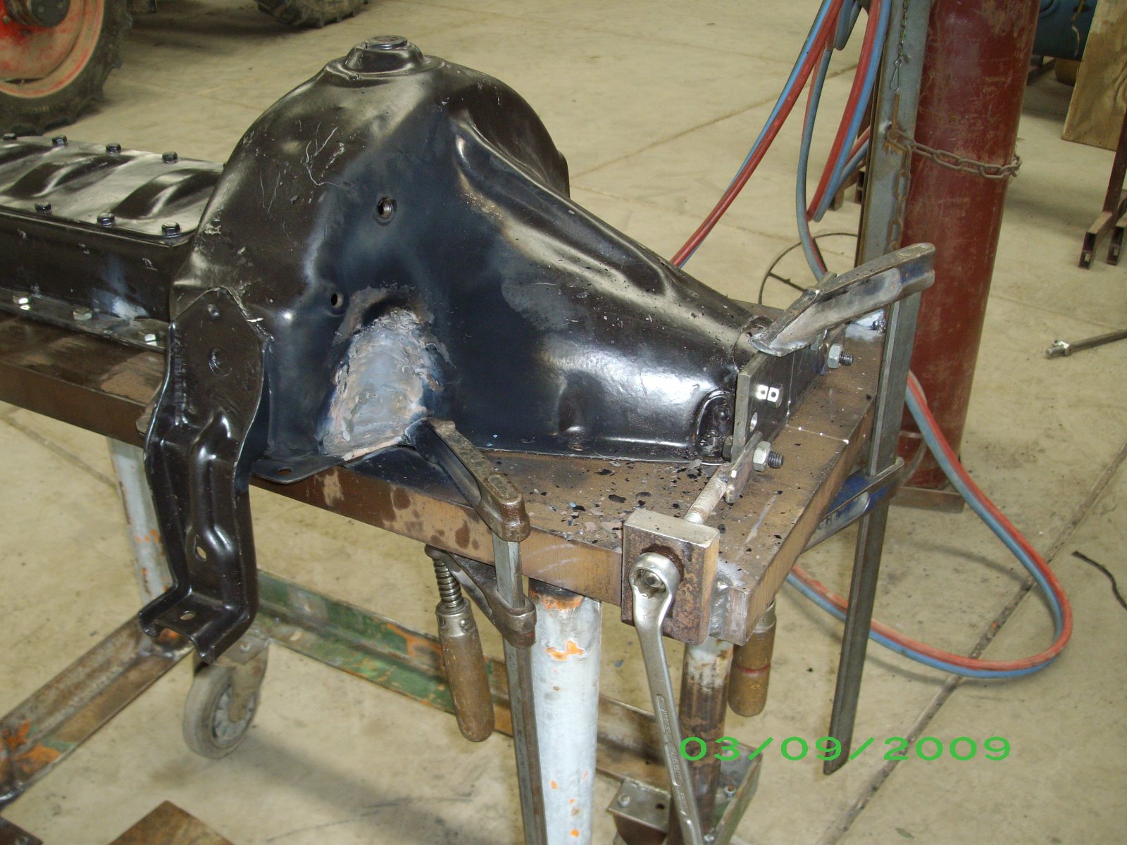

Kenneth ; Here are some pictures of my home made Straightening table .
Unfortunately I dont have the right location for the pan arms.

Fact is, a few people have built their own pan straightening table jigs. I thought maybe by now someone having done so might have responded. To do it right, heavy enough steel plate (tried to buy any of that lately?), milled FLAT, adequate number of index holes (Don't have to have ALL of them, but about a third at least) both sides, front of block to back of hogshead. All index holes accurately drilled and pegged within about 1/64 of an inch might be good enough. The front engine mount NEEDS to be indexed precisely, in three dimensions. The rear (U-joint) end must be similarly accurate. The pan hanger arms need to be within an 1/8 inch in all dimensions.
One forum regular shared the process of building his own a couple years ago (I think I remember who, but won't say in case I mis-remember). As I remember he was nearing a thousand dollars in materials and machining costs when he lucked into a real one for about what he had already spent!
Many years ago, well before the internet, I understood the need to have the pan really straight. Without a jig/table, and no internet to help search or find one, I figured out how to check and straighten pans using known good straight edges (machinist accurate straight edge rulers or other accurately checked ridged steel), working in multiple directions, and VERY carefully measuring and triangulating nearly ALL pan bolt holes. Special care must be taken with the nose of the pan, and arms are a bit tricky.
IS it really a good way to go? Definitely NOT! But it is better than nothing. Best advice? If you cannot find or afford to buy one? Find a club member close by that is willing to share his.

Great topic, Anthonie, nice build, with a few more location tabs for the arms and location bushing for the crank/front mount your pan straightening table could be as good or better than the Wilson. As Herm has said, if you could start with a really straight pan, you could use it to  install locating tabs etc.  In my case I thought about building such a device but decided that I couldn't possibly used it enough to warrant having one. A guy in our club acquired a Wilson , but needs to get all pieces that go with it.  Can anyone supply any information as to what  pieces the Wilson jig should have? Thanks jw

Here's the one I built many years ago with the "critical" dimensions courtesy of Herman K. !  Seems the K.R.W. fixtures don't come available often so I made my own - 1 & 1/4" T-1 steel plate that was surface ground both sides to .0001.

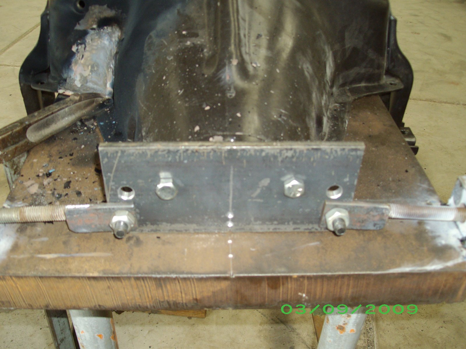

I am in the process of restoring a KR Wilson pan jig. Ill be posting a thread about it soon.
But for now here are some pics of the attachments. The first five pics are of original pan jig and attachments. There are two styles of the front hand crank bearing attachment. The single bolt style seems to be the most common. all the attachments are locked into place with dowel pins after final alignment calibration is achieved. The other pictures are of the Langs castings. They worked very well for me, but you must be very careful when machining them as there is very little extra material to work with.

I  forgot to mention that the Lang's castings come with detailed drawings with the machining measurements for the castings, as well as dimensions for the other fittings. I bought my material for the tail shaft and pan ear bar, as well as the locating pins from McMaster Carr. , following are the part numbers
1. pan ear bar, 3/4 x 1-1/4 x 24 inches, flat bar, part # 8910K765 cost = 29.52
2. front test plate (single bolt style), 1/2 x 1-1/2 x 5 inches, flat bar, part# 8910K939 cost = 7.68
3. tail shaft, (rotary shaft material) 1-1/4 inches diameter x 12 inches long part# 1346K44 cost = 43.24 I bought this shaft longer than the original KR Wilson shaft so I could let it stick thru the tail shaft casting several inches. I machined 1/2 of the excess shaft away so it could clear the table top. I did that so I could use the excess shaft to help in aligning the tail shaft casting to the centerline of the table.
4. locating pins, 3/8 head x 5/16 shank, amount needed =10, part# 8472A13 price = 3.53 each The 5/16 shank is plus .001 and the 3/8 head is a little smaller at aprox minus .001 to allow for a press fit in the table and sliding fit in the pan. The only issue with the pins is they are too hard. I broke a couple of them when I started using the jig to practice straightening pans. I annealed the pins by heating them to a "dull red" with my cutting torch and letting them air cool. I have had no more problems after annealing them. By letting them "air cool" they are still plenty hard to use, but not so hard they break like a file. Other than the shape of the head point, the McMaster Carr pins are identical to the KR-Wilson pins.
There are 10 pin holes in a KR-Wilson table. 6 of them go all the way thru the table top. But the 4 holes at the pan arm are "blind" holes. If you break a pin at the 6 "thru" holes its easy to just drive the broken piece thru the table top. But the 4 holes at the pan ears are another story. If you break one of them, the pin will need to be "drilled" and "tapped" for a small bolt to act as a puller. If you do not anneal the pins, it is almost impossible to drill and tap the broken piece. (do not ask how I know this) So I highly suggest to at least anneal the four pins at the pan arm area. (you have been warned)
5. front test pin for hand crank, 3/4 x 7 inch, round rod, I can not find the part number. price = 16.64 any good 3/4 inch round rod should work, I just bought a new one so it would be shiny and well machined.
The only thing I have left to do is take my freshly straightened pan to another pan jig and see if my table alignment matches a known table. If my alignment is OK then I will drill and install the dowel or taper pins into the Langs castings to lock them into place.

The following pics show how I used the excess tail shaft and a machinest straight edge to align the tail shaft casting to a center line.  The drill bit is used as a locating pin to establish one end of the shaft to the center line, and then "swing" the other end into position using the straight edge to show a paraelle measurement at both ends of the straight edge.

Re: Pan straightening
John, I am almost done with the speedster project.   The rebuilding of the engine is the last major item.   I have the entire engine and transmission assembled and ready for the pan installation. I also have the Rajo 4 valve installed on the engine.   So instead of just using the pan jig one of our local club members has, I opted to use this time to rebuild my pan jig to use to straighten the speedster projects pan.   So in a way, rebuilding the pan jig is part of the speedster project rebuild. and now we have another pan jig in Arkansas for others to use ....
I plan on a "pan jig" rebuild thread soon. But I have to verify my final fixtures settings and install the dowel/taper pins, before I call the pan jig done ...

- Posts: 5358
I had  a similar experience as Larry which is what prompted me to build my own fixture (with help) - see above photo.  As Larry eluded to, 4 dip c.c.'s are notoriously weak at the radius rod socket which can & will get pushed in from a not so hard impact of the front wheels - next thing you know, the flywheel is rubbing !
Mark Nunn
- Posts: 1270
- Last Name: Nunn
- Location: Bennington, NE
Is there a drawing or diagram that shows dimensions of the wishbone support relative to some fixed location on the pan?  I know for a fact that my wishbone support has been hammered rearward over decades of use as a truck.  I have not addressed the current wishbone ball to socket alignment yet.  I need to re-bush the front shackles first to ensure correct wishbone location.
- Posts: 5358
Nothing I've run across, yet.
