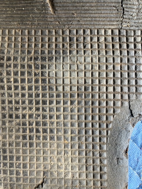

Hear some pictures of an original 1910 floor mat. It’s clearly made with duck as the blueprint says. It’s with dark gray or black in color at this point in time. Hard to say what the original color was, but I don’t believe it was anything close to white!

What a treat to see this relic ! Thank you Kim.
