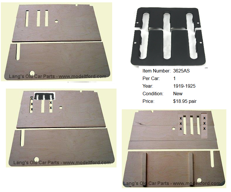

Changing pedals lots of work.NY John T wrote: ↑Fri May 19, 2023 9:55 amHi all,
I have a 26-27 Touring body on, I think, a 21 chassis. The pedals are evenly spaced apart. The floorboards for the later transmission don't fit these pedals. Has anybody had this experience? Do I need to make custom fit floorboards to fit the even spacing pedal slots? Anybody have any measurements for the 26-27 Touring with a '21 transmission? I may have to do a cut and paste with cardboard. Thanks.
John
Since you know that the later transmission floorboards don't fit your pedals can it be assumed that you have set of '26/'27 floor boards to work with?
The '26/'27 low speed and brake have a larger offset section to space them further apart but reverse stays the same as. <good news!
I would first try to make a custom set using '26 board & purchase the Pedal trim set ( Item Number : 3625AS Year : 1919-1925_) to use as a guide for pedal spacing. Cut the cardboard the same as the upper position of the floor board and just cut out the slot for the brake pedal. The use the trim set as a guide for the other two slots & cut them out. Cut the cardboard across the pedal section using the the trim set. Check for pedal travel.
Good luck

Topic author - Posts: 437
- Last Name: Killelea
- Location: Northport NY
Re: Floorboard dilemma
Thanks so much for the suggestions folks. I think I'll work with cardboard to get a layout, and see if I can cut the (26-27) floorboards to fit, or I might have to build custom boards. I don't want to take apart the hogshead or replace the pedals. Thanks again.

- Posts: 6558
John
Donnie Brown brought up a good point which I had overlooked, in that the pedals may well need rebending back to their original configuration both side to side and fore/aft.
Be sure to do this before cutting wood. I'd suggest your buying the pedal slot/covers that clinch to the wood before you do anything, and bend things so that they will line up with the metal slots. Then you're set to commit to cutting up your new floorboards
Finally, notice that the low pedal moves "right" when depressed (so should be at rest on the left side of the slot) and reverse and brake move "left" when depressed, so they should be at rest on the right side of the slot. Failure to understand this in the beginning will lead to lots of extra work and frustration and maybe even stuck pedals...no one wants that
