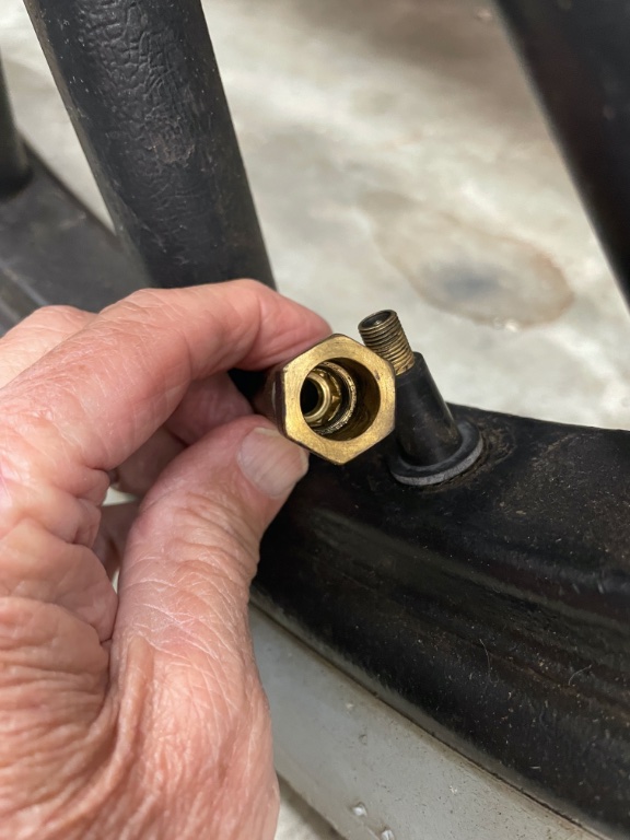

My first T so learning quite a bit. I have 21” wood wheels on my 26 Roadster Pickup. I went to check tire pressure but was surprised when I removed the dust cap on one of the wheels. It looks like the stem and valve are inserted into a larger stem and valve. At first I thought the dust cap cap apart and left part on the wheel but in comparison to the other dust caps it doesn’t seem that’s the case. Before monkeying around I figured I’d asked the club. What setup do I have in this wheel and how do I access the valve to check pressure and pump up? Didn’t want to break anything

Those are accessory stem covers to look like old timey covers ! The adapter came off from inside.

You have an aftermarket dust cap setup designed to adapt to a modern rubber stem tube. The threaded insert inside is adjustable to compensate for different heights of rubber stems. I am running them right now on my 1912 Flanders 20 because it came to me with rubber stem tubes and I don't want to change them out for now.

the answer to your question is this: your aftermarket valve cover has come apart and left part of itself stuck/threaded onto the tire valve. Use a padded pair of pliers on those threads and they will screw right off, leaving a normal looking rubber stem exposed, to which you may add air.
Your old cover may or may not be repairable by applying a small dab of epoxy and screwing the thread adapter back in.

Jim - carefully twist off the little brass piece off the tube stem then air up your tire. You need a large hex wrench to screw the adapter back into the cover.

It shouldn't be on there super-tight. Once you get it off, screw it into the inside of the dust cover far enough to keep it from bottoming out on the threaded part of the rubber stem before the dust cover bottoms out on the felloe. The ones I bought for my Flanders came with a round rubber gasket on the bottom to act as a cushion between the dust cover and the wheel felloe.

Here is same type repro cap for rubber stem tubes in brass. The insert is threaded for the valve stem, and is adjustable for depth depending on the wheel application. Once you get the insert out, it has very small splits that you can pry out just a little, and that gives resistance to backing off with the larger threads inside the repro cap. The insert uses a 3/8" hex wrench to position it back to where you want it, trial and error, but you'll want the cap to bottom out on the wheel felloe, or that insert can stick like that one did.
