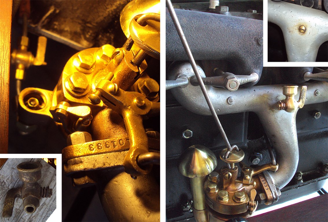

The day came to install the 5-ball. I took some pictures to remember it before it goes under the hood.
The gas line is the same length but enters the Kingston lower which involved putting a couple on bends in it. Getting a tubing bender into the available space was tricky. The two mounting bolts were too long so I found shorter ones. I slotted them for easier installation. This carb doesn't have a choke, but a tickler which pushes the float down to let gas into the chamber. I noticed the previous choke rod had a notch worn in it from the radiator sheet metal. The repro adjusting rod had too large a diameter where it goes into the two holes on the needle valve. It will fit but binds when turning. I had an original which worked better. After these and a few other tasks I was ready to turn on the gas and see if it would start. Gas began dripping from the bottom of the float bowl. I mistakenly suspected the float level being wrong, so I took the bowl assembly off and added a shim to the float. Reassembled, it still leaked. Probably two hours, no longer at my best, I fiddled with the float, both on the car and on the test jig. With no improvement in the leakage, it occurred to me it wasn't the float after all. There is a copper crush washer that seals the bottom of the bowl and the sleeve/nut that holds it to the carb body. I had added a thin gasket and it sealed fine on the test jig. However, in assembling this to the body, the sleeve did not tighten enough to seal. Other discussions talk about a lead washer here. I tried a thicker washer, and all was well. I now had the float shimmed for a lower fuel level but decided to give the car a crank. I have used Vowel Art and some of FordFix pics here.
Thank goodness it started and after fiddling with the adjustment it ran quite well. It accelerated nicely.
By now, the gas line fittings were seeping from all the assembly and disassembly, but life was good. I shut the gas off again and called it a day. I suppose the sediment bowl valve will start leaking too now, as it got a lot of use during the ordeal.
I will work over the fittings and take it for a test drive.

It would seem a simple job to unbolt the L4 and bolt on the Kingston. It didn't turn out to be.The gas line is the same length but enters the Kingston lower which involved putting a couple on bends in it. Getting a tubing bender into the available space was tricky. The two mounting bolts were too long so I found shorter ones. I slotted them for easier installation. This carb doesn't have a choke, but a tickler which pushes the float down to let gas into the chamber. I noticed the previous choke rod had a notch worn in it from the radiator sheet metal. The repro adjusting rod had too large a diameter where it goes into the two holes on the needle valve. It will fit but binds when turning. I had an original which worked better. After these and a few other tasks I was ready to turn on the gas and see if it would start. Gas began dripping from the bottom of the float bowl. I mistakenly suspected the float level being wrong, so I took the bowl assembly off and added a shim to the float. Reassembled, it still leaked. Probably two hours, no longer at my best, I fiddled with the float, both on the car and on the test jig. With no improvement in the leakage, it occurred to me it wasn't the float after all. There is a copper crush washer that seals the bottom of the bowl and the sleeve/nut that holds it to the carb body. I had added a thin gasket and it sealed fine on the test jig. However, in assembling this to the body, the sleeve did not tighten enough to seal. Other discussions talk about a lead washer here. I tried a thicker washer, and all was well. I now had the float shimmed for a lower fuel level but decided to give the car a crank. I have used Vowel Art and some of FordFix pics here.

Looks great Rich. Thank you for the photos and posts. Now to get you to make a service call….

Thanks Rob. I'm not sure I could help but if I lived closer, I'd try. I mentioned the fittings seeping. I made new gaskets for my homemade swivel and new tape on the pipe fittings. The machining on the swivel wasn't perfect and the gaskets wore a bit. I also put some discarded red rubber hose on the gas line to keep it from wearing or rattling against the hogshead bolts.
These are the things that make the hobby so delightful. It reminds me of the surprise I got when my first T started after rebuilding the engine. I was 16. Most projects have their bumps and disappointments so when things go well it is pretty wonderful.
I have always been leery of brass carburetors until I built a Holley G for my '14 last year. I will tackle the four-ball for it in the future.
Reaching out to new things keeps the hobby fresh and interesting. My '09 is one step closer to being legitimate now.
I'll take a nap and then go clean up the shop from the last several projects. It was getting tough to get around in it.
I won't bore you with the difficulties in getting up and down on the creeper and the other complaints we older guys get through. The joy of success overshadows it all.
Good for now.
After turning the gas back on, I noticed some gas coming from the threaded end of the float arm pivot screw. I backed it out and smothered it with fuel lube and tightened it back down. That may have been some of the gas showing on the fittings.
The rewarding part of the story is that the car started on the second pull without "tickling" the float. It runs well. I took it out for a 4-mile spin, and it works every bit as well as the L4. It seemed I could even go faster with the 5-ball.These are the things that make the hobby so delightful. It reminds me of the surprise I got when my first T started after rebuilding the engine. I was 16. Most projects have their bumps and disappointments so when things go well it is pretty wonderful.

Topic author - Posts: 6895
Re: My Kingston 5-ball and it's float level
By making a 5/16" longer plunger, the float can be "tickled", or pressed down to let more gas in the air chamber. I'm still curious why it was necessary.
The slight leak persisted with various changes in float level. I will say that it was a good suggestion to shim the float rather than bend the cast brass arm. I would have broken it by now with all my experimentation. I concluded the float valve might be the problem, so I made a new one. It was a new challenge and came out quite well. However, the leak continues as before. Perhaps the seat is the problem. I guess the fact that the carb has never leaked on the test fixture but leaks in the car is because there is more pressure from a tank of gas than the cup I use for the tests. That surprises me but is so.
Since the car runs and starts well, I will live with the leak and simply shut it off overnight until I get the bug to look at it further.
- Posts: 1145
- Last Name: Gould
- Location: Folsom, CA
That's pretty delicate work, Rich. Those 5 ball needles are small!
It is small Richard. .097 stem. Bronze can grab the bit, chatter and break it quite easily. The excess play in my lathe makes that very possible. I'm not a trained machinist but have learned a bit as I went. Going slow got the job done. Watching the marvelous work that other, better trained have done always encourages me to try.
After running a few miles, the carb does not leak during the day, but a small spot where gas has leaked still shows up each morning.
Other than that, it seems to work great.
Thanks Kim. It is unbelievably gratifying to work on parts this old. I have enjoyed your projects for many years now and happy to have some too.
On a trip in the moist air this morning, a few skips in the rhythm made me wonder if the manifold was icing, but not enough to be trouble.
I showed the carb off to some of the coffee guys with later cars and they could see the magic in my 5-ball.
