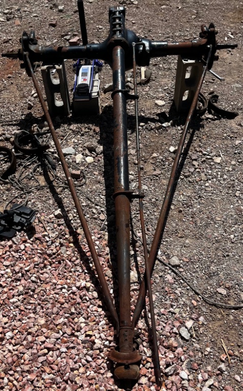

Thank you Tom. Really any shifter that mounts to the u joint bolts should be able to work. I have an early TT Ruckstell with no shift lock so it will be interesting to see what I find when I crack it open. I will probably get into it in about 2-3 weeks.

I think you might run into some fitment issues putting the shift lever where you are thinking with the Warford mounted behind the end of the transmission. The L shaped lever at the front, puts the shift rod more or less going through the Warford, it will need to go around it.

I was thinking about that as well. I might have to do some fabrication because my frame was also extended for the Warford. I will have to see and example from someone else who has both of them on their TT.

My first suggestion was to clean off the outside but I see you've already done that. Some of the housing half bolts can be a bugger, there very little room for sockets on a couple. Have some kind of support, those housing halves are really heavy. When I split them now i have a stack of pallets 5 high with a piece of plywood on top. It allows you to rock the housings and pull off one half. Be ready for the sludge that is inside, you hope it's there, it will have protected the parts inside from moisture.

Did the TT's use two shift rod supports, or did someone just put an extra one on?

Thank you Bob. I’m in no rush to put it on. I still have to remove rust, check the perches, prime it, paint it, and then figure out how to get the shifter and rod to connect because I have a Warford and an extended frame.
