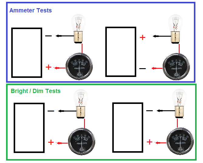

Its difficult to provide assistance unless your descriptions are more detailed. You did a fairly good job about what you have done with the cutout & generator but still haven't answered questions about the ammeter & exactly what headlight bulbs you are using.Barteldes wrote: ↑Sat Jun 03, 2023 12:49 pm1924 Coupe
i wasn't getting any reading on the ammeter so i watched a few videos and set my cut off switch to 6.5 (It was at like 2) and started moving the third brush. (toward the engine) Still nothing shows on the right side of the meter. I do think the meter is working as it shows a negative 1 when i turn on the lights (brights). Is my generator shot? I did try looking at all the connections. I took off the ignition / meter assembly and even tried to clean the gauge a little. Previously i had some trouble with the lights only the dims worked and after messing with them now only the brights work. I have no clue why. and before when only the dims worked the meter didnt move.
im thinking the generator doesnt work. wadda yall think?
Unless you have confirmed you have a properly functioning ammeter your attempts to adjust the 3rd brush is pointless This was discussed in your previous discussion entry. In this one you said you "tried to clean the gauge a little" - how ? internally or externally? But that seems to imply you haven't replaced it yet. Having said that, consider this. If you have a bad ammeter that doesn't register a charge does this mean the generator is not working? No!
Here some set up to resolve ammeter & Bright/dim issues
-Ammeter Test is just to verify that the ammeter moves equally in both directions when a load is applied simply by reversing the battery connections.
An LED bulbs may only in a slight movement 1 amp while a filament bulb would do 2 or higher. If you only get movement in one direction then the ammeter is bad. No point in resolving the generator issues till you have a good ammeter.
The Bright/Dim tests is to verify if the bulb is equivalent to a dual filament incandescent bulb if its an LED. No need to reverse wires, just take the bulb out and reverse the pins when replacing it. You should see a difference in brightness.
Now the issue you have with the headlights only working on either bright or dim but not both - can be a bulb issue or a wiring issue. Th wiring to the headlight biulbs should be in parallel to the terminal block

I have ordered a new ammeter and two kinds of bulbs with dual filaments. The bulbs i have only have one contact at the middle of the stem. the ones i ordered have two contacts. My attempt of cleaning the ammeter was tentative. I cleaned it outside with electrical cleaning spray (for sensors and such) and took off the cover and seeing how delicate it was i got very careful with it. i did spray with an electrical spray. i dont have the can in front of me at the moment to tell you what kind. I sure appreciate all the help you guys are amazing.
