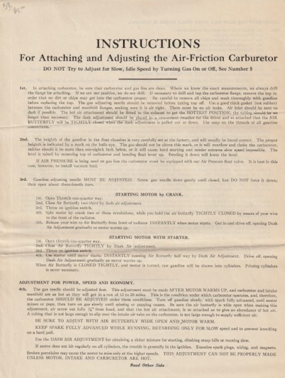

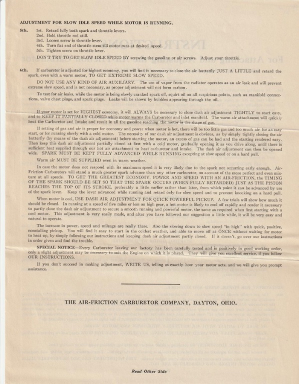

Jay Busico posted these scans of the manual for the Air Friction back in the Accessory of the Day threads.

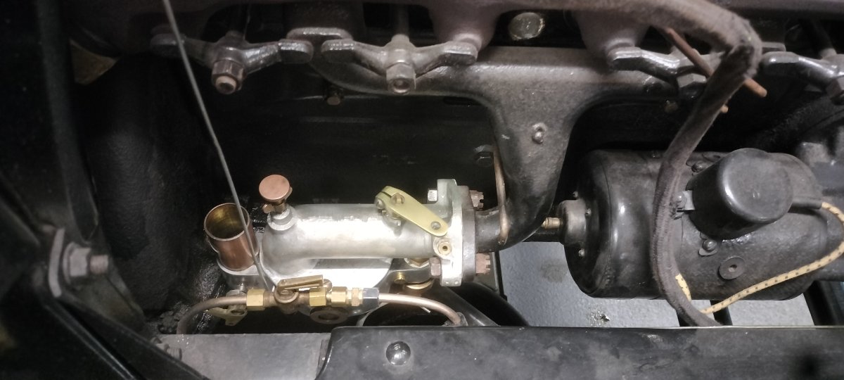

Image 4-16-23 at 12.29 PM.jpeg (60.24 KiB) Viewed 3136 times

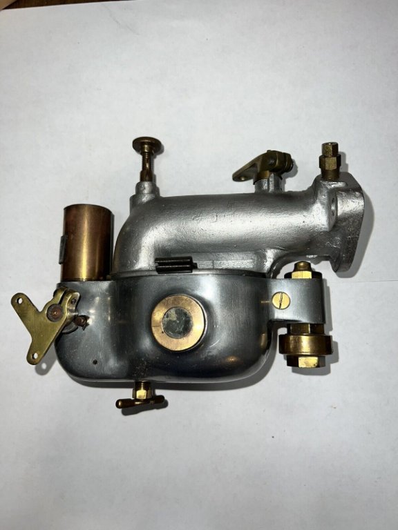

1924 Air Friction.jpeg (73.66 KiB) Viewed 3136 times

Ah yes, that's what I was looking for, thanks! And Scott, that's about where I thought I was gonna end up. Just trial and error. Basically I bought this carb because, well I can't afford a Stromberg, and because the old nh is just so crude and we have a lot of hill where I live and I was hoping something with a little more adjustment may help a little. Not sure that it will but it's worth a shot. I can't climb anything with that nh unless I'm in low. And I've completely rebuilt the engine, bored, high compression pistons, adjustable tappets, basically everything but the balanced crank (which I also can't afford) but it's such a dog. Runs fine on flat ground but these hills are just too much for it. I've tried different nh's even, thinking maybe I have a passage locked or something but they all act the same. Makes no sense to me and I've built engines half my life. It's got me stumped for sure so the only thing I could figure is maybe those nh carbs are just so crude they can't handle steep hills.
