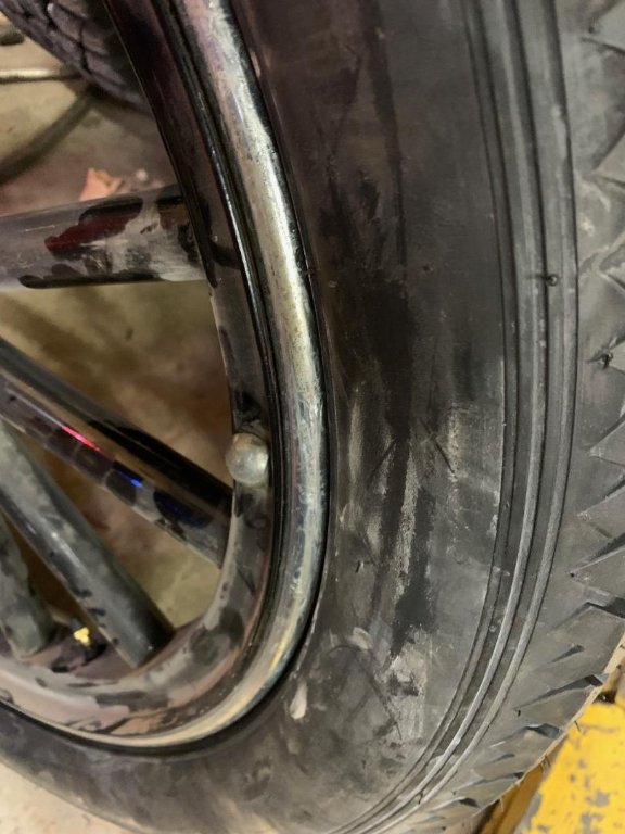

This weekend I installed new tubes into my new Riverside tires and put them on my new Australian rims.    Some of the valve stems seemed to point straight, some lean outboard.   Should I be concerned?     The tube holes in the rims and the wheels are slightly outboard of center.      The tubes have a blue stripe on one side.  Is the blue stripe meant to identify which side of the tube is outboard?    My tubes seem inconsistent.

Here are some pictures.  I tried another rim on that same wheel with the same results.  Is it possible that I have a bent felloe?

If those are 3 of the rims off your car, they are all different manufacturers so that isn't helping out with the rim seating on the wheel issue.  I see one Hayes with the "foot" that seats into a matching cut-out on the felloe - a copy of a later parts list shows the difference in rims.

The one on the top and on the right is the new one.  The next one came off that wheel.  The bottom and left one is from the other rear wheel.

I found this picture.  It appears that my new rims are the Ford type 2845B.  I have read that the Ford and the Hayes should work interchangeably.   So, my next question is How to identify the different felloes?  I see the notch in that Hayes felloe in your picture.  What else do I need to look at?

Scott, your new rim is not a Ford 2845B. The 2845B rim has a solid steel bead around the circumference and a flat base on the rim. Your new one has a rolled in bead and a corresponding groove around the base of the rim. That type of rim with lugs fitted is a hybrid I have never seen. On the Kelsey wheels fitted to our Canadian sourced cars, the rims with the groove rolled in them are fitted with loose lugs, not fixed lugs. The loose lug felloes have a different cross section to the fixed lug type felloes. The rims  do wedge on the outside edge of the felloe, whereas the fixed lug type wedge on a wider inside land on the felloe.
Either way, I believe the rim is the cause of some of your problems. The valve stem hole should be central on the rim. The combination of rolled in groove and fixed lug may be adding to your dificulties. Does it fit properly on any of your wheels? if not, I suggest you contact the maker/vendor who sold it to you to seek clarification/rectification. Detailed photos of the felloe might help.

Check out this earlier post on those New Rims. ESP. The comment from Mark. Could be same issue, one lug bolt isn’t seating, so the lug may need ‘opening’ a bit so the rim can have clearance to slide on the felloe.
https://www.mtfca.com/phpBB3/viewtopic.php?f=2&t=35342
Typical Hayes rim, the lug bolt hole nearest the valve stem most times is slightly oval, so then the rim is placed with tube stem in the felloe, the bolt is entered last after the other 3, so the bolts can pass and the rim fits snug, prior to adding the bolt lug nuts.

I have mailed Steve about the issue and have not heard back from him yet.  But I think Dan "hit the nail right on the head"!   The bolts do not all line up perfectly.  I assumed it was mainly that the rim was not square to felloe when starting them on.  Here is a picture of the lug hole next to the valve stem taken after the bolts were snugged up and the rim and then removed.  The misalignment will get worse as the rim moves towards the felloe causing them to bind up.
Martin, the one that I was able to force all the way on does not wobble. I suspect that you have the same issue that I have. Have you looked at the back side of the rims to see if they are up against the felloes?

I believe the ovality in the lug hole nearest the valve stem is purely to aid in the fitment of the mounted rim/tyre/tube assembly. The square under the head of the rim bolts was originally upset a little so the bolts stayed in the felloe. With the car jacked up and the valve stem hole in the felloe at the top, the rim is fitted by angling the left side out away from the felloe and the right side a little over the felloe as  the valve stem is inserted through the felloe. Then the skewed rim is rotated to align with the felloe. It is then that the ovality in the lug allows the rim to go on over the captive bolt. Close inspection of a good rim will show the countersink in the lug around the bolt hole is concentric with the bolt hole, the ovality created by machining off part of the countersink on the lower right side of the hole.
Today, with the bolts no longer held captive in the felloe, it is just as easy to tap the bolt nearest the valve stem back, fit the rim and then tap the bolt back into place.
Our Canadian sourced cars came with Kelsey wheels. Until 1925, they were all used loose lug rims. In 1925 we finally saw fixed lug rims. Being Kelsey, there was no foot on the lugs, so the rime bolted straight up and wedged on the wider inner land on the felloe, the lugs being proud of the outer face of the felloe. I have never seen a 23" wheel with the straight up outed edge of the felloe as shown in an earlier post. Those only came on the 21" wheels introduced on the improved 26-7 models. Any Hayes wheel I have seen has the same rolled in outer edge on the felloe as the Kelsey wheels, with a depression pressed into the rolled edge to accommodate the foot on the Hayes rims.

I am making some progress!  I tried to put that rim on one of the front felloes and had the same issue.  I tried another rim on the front felloe and it went on easily.  So, I took it back off and put it on that rear felloe.  It went on ok.  I think that felloe is tweaked a bit.  Not sure, if I did that with the 5lb leather mallot trying to get it to seat, or if it was already that way.  I need to put it back the axle now and check the runout.  It appears that the lug to the right of the stem is out of position.  I removed the nuts from the bolts on both of the rear rims and the bolts are not binding up at all.  So, I think I have a lug that is out of position.   I need to continue and check all 5 rims to see how many are defective.  Here is a picture of the misaligned lug.  It is the one on the opposite side of the stem.  So I might have two different issues going on.   I did receive an email back from Steve and he will replace all of the defective rims.

Scott, thanks for reaching out to Steve with your problem. It gives vendors valuable feedback about their products, and a good vendor will do what can be done to fix the problem.
Re the possibly damaged felloe, it can be checked for run-out and out of round by spinning it on the car. Put a block of wood on the shop floor adjacent to the felloe and rotate the wheel by hand, checking for run-out against the block. Few well used wheels will be absolutely true, but this check will give you an indication. Then jack the car a bit and put the block under the wheel to check for out-of-round. Out of round is a more difficult problem to deal with.

The short answer is maybe yes, but you shouldn't. Fixed lug rims are designed to wedge on the inner land on the felloe. This wedging effect is what takes the "drive" from the wheel to the rim. A bent felloe will result in a very poor wedge fit. The four bolts and lugs are there to maintain the wedge. If you stack washers/shims so that the rim can run true, all the "drive" will be taken by the four bolts. The lugs should stand off the outer face of the felloe.
I would rather run with a rim firmly wedged on the felloe with some run-out than compromise that fit for the sake of a true running rim.

Re: tube question 30x3-1/2 demountables
Here are pictures of 2 of my felloes.  The top one is the rear one that I drove the rim onto.  I was able take if and lay it on a block of wood and drive it off.
The bottom one is a front one. I can get 1 rim on with a little more wobble than I like.

Scott,
Just a thought: The rear looks like it has a lot of paint on it. It may help to strip the old paint and give it a fresh thin coat.
The wheels had been blasted, primed and painted when it was restored in 2010.  So, the paint should not be an issue.  However, I am happy to report that I now have 4 of them mounted on the truck!!  The worst runout is about 1/4" at the side wall of the tire.  I started with one felloe and beat all 4 of the rims on and off and back on.  Then checked the runout on them.  Then moved to another felloe and did the same.   The fifth rim will not mount on any of the felloes.  That is because the lug is out of position.  I emailed Steve the good news and informed him that we only need to replace 1 rim. Thank you to everyone for helping lead me in the right direction.
