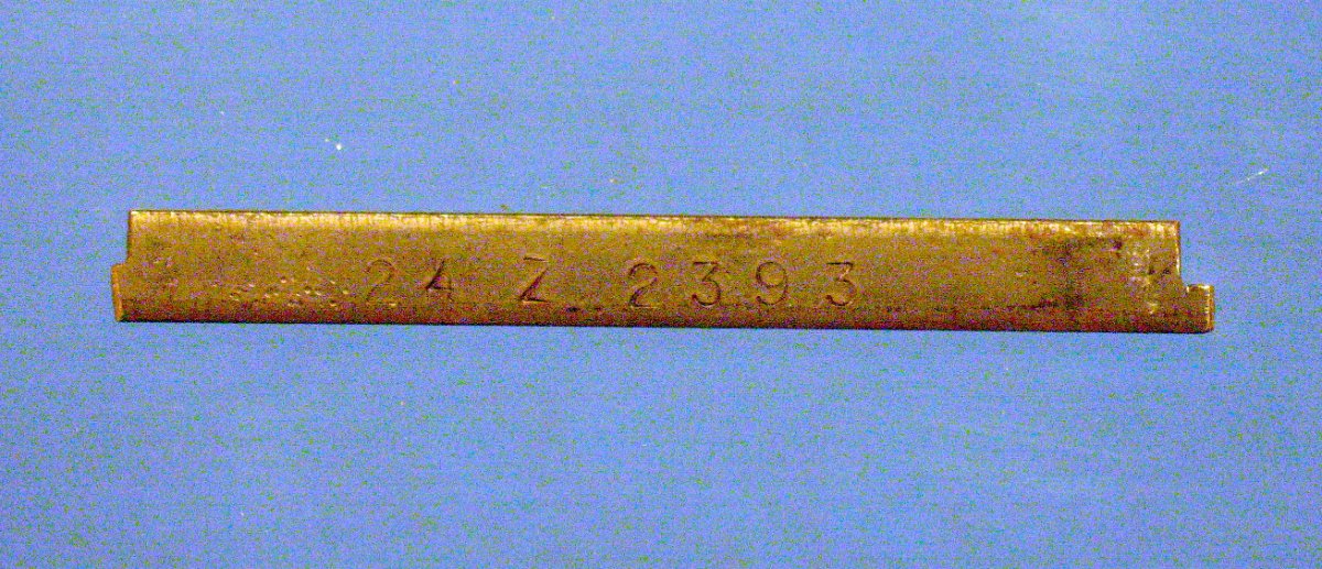

Setting the float level is best done on the bench. The MTFCA Carburetor book tells you how.

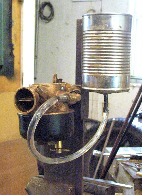

Home made level setting tool. Crudely made, but it works.
