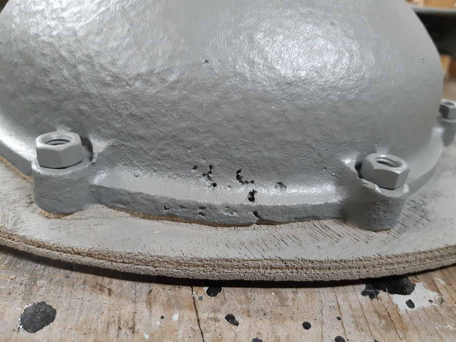

The large spigot in the middle of the flange is turned to be a slip fit in the inner bearing sleeve hole in the center housing. The center casting can be alignment checked by placing it over the pin and checking with a feeler gauge around the bolt flange where it meets the gauge flange. The gauge plate is also drilled for bolts so that the housing can be direct bolted to the base when working on. Each of the 5 housings that I tried on the jig all fit well against the base flange when slipped over the gauge pin. So, although there could be some miss alignment of the center casting, its likely about “as good at the factor made it”.
And interestingly, all 5 housings appear to be “bent” in the same general direction. Slight “ahead” and mostly “up”. So, it suggests a combination of overtightened radius rods and lots of weight on the rear end when driving.

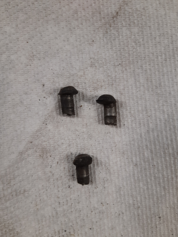

I spent some time thinking about rivets vs bolts for this application. One of the projects for this T was to re-rivet nearly the entire frame where someone had removed many of the rivets and installed the wrong later rear cross member. I did a fair bit of rivet research and experimenting. I do believe that Ford, or more correctly the suppliers cold riveted the frame and most parts using specialized jigs and hydraulic rivet presses. Smith Brothers who made frame for many of the early, and later manufacturers used this method. To get good clamping pressure between the two plates requires a lot of force. Placing two plates or parts together and installing a rivet and hammering (or even heating and hammering) may spread the rivet in the hole, but is not a guarantee that it is providing a good clamping force for the two parts. I tried several test pieces using a 10-ton hydraulic press, plain hammering, and heating and hammering. In most cases, even with good looking rivet heads, the two test pieces could be wiggled as the clamp force was low. When re-riveting the frame rivet jacks were used as much as possible to help with a pre-load clamp force and then the rivets were heated and hammered. And even then, 1 in 5 had to be re-done to be really tight.
General comments.
When I took two of the housings apart it was obvious that these rear end rivets did not have good clamping force unlike most frame rivets. When removing frame rivets, I usually have to drill most of the way through then use a punch and hammer hard to get them out, and they are hard to get out. When removing the rear end rivets once the head was ground flush, the rivet could be easily punched out with a drift. They were NOT tight from the factory. And see the picture below of some of those removed, many were not even pressed squarely from the factory. The shape of the rivets showed that they were pushed in from the outside and then pressed on a fixture to mushroom the inside end of the rivet. And most were not even close to being on center.
Bolts can be torqued to produce more consistent clamping force, but don’t spread to hold the parts in alignment unless they are fitted bolts. Rivets work well for alignment as the spread out to fill the hole and hold the parts in alignment, but they don’t produce reliable/repeatable clamping force. So, I did the hybrid. Two rivets to prevent movement of the parts, and stove bolts to hold them tightly together. I did make an anvil jig to help with the riveting which made it go surprisingly easy in the end, but the two main parts could not be pre-clamped together so relying on the hammered rivet only for clamping force didn’t satisfy me. A picture of that jig is also attached for information.
And I would comment that this era of Ford rear axle was not very well built by the supplier. The design uses “sloppy” fit tolerances by most modern standards. And the center housing castings are not very good either. Lots of bubbles and voids in portions of the outer sides of all of them. I expect that under modern quality standards nearly all of these castings would have been rejected at the factory. Most of these defects couldn’t be seen until they housings were sandblasted. And there is a range in the quality and every one has some level casting imperfections. Mostly on the outside at least, the insides appear much better. A picture of one of the worst examples below.
Wonder why Ford choose rivets then... ;)

with respect to the rivets not being tight from the factory, that was 100 years ago and quite a few "jack under the differential" lifts. I'd wager that they were perfectly tight the day it left the factory ;)
