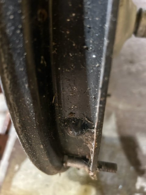

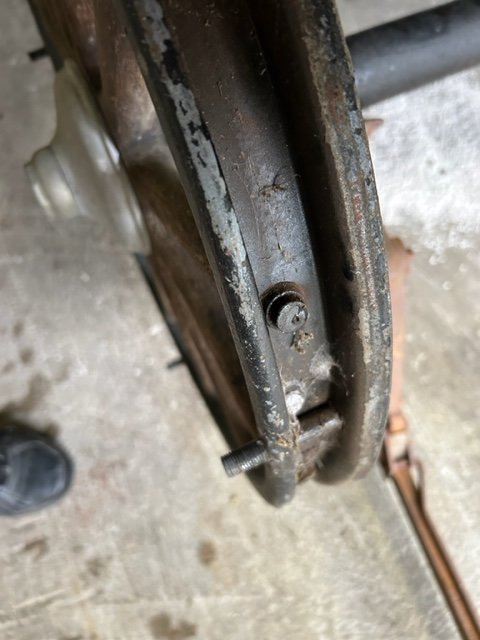

I might have to pull the rear wheels as the rear drums are oily or greasy so the brake bands aren't doing much. It has a Ruckstell axle and Rocky Mountain Brakes. I assume the first thing I need to look for is leaking axle seals.

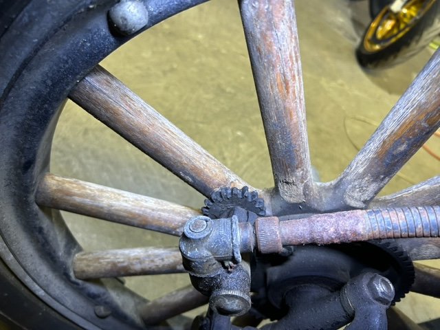

Another thing to check when assessing the spokes - with the demountable rims removed, look at the conditions of the tenons (the part of the spoke that pokes thru the felloe.) If it looks like a wart, it has been compromised and the spokes are on borrowed time. A good whack on such a spoke sheared off the tenon as shown in the first photo.
Should look like this

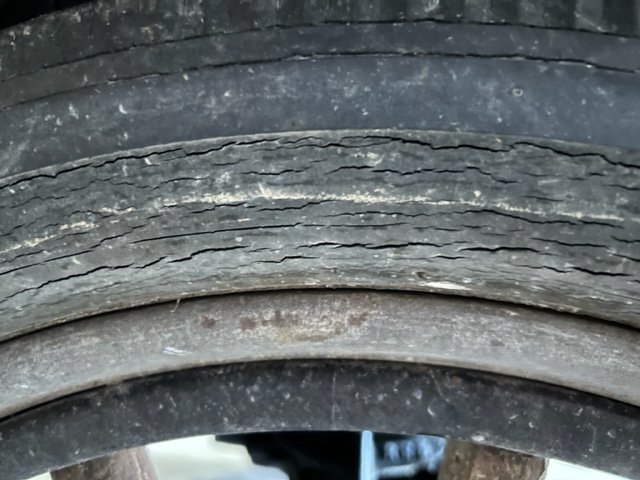

Here are some close ups of some of the cracking in the tires: They're Coker tires. One of the tubes has a leak, so we'll see how it holds up when we break the bead.
One of the front wheels has some spoke damage from the speedometer. I'll pull a rim or two and see what the top of the spokes look like.

well, you can ditch my hopeful reply on the tires! The good news is that they're probably so hard that the leaking one won't go completely flat.
Get experienced help when you remove them. I just removed a set last year that looked like that after rolling the car around for 8 years during a very SLOW restoration. One of the 3 came off in pieces and all 4 were welded onto the rims with hidden rust. The Riverside tubes inside were pristine, and can be reused...thus my point about getting help removing the tires without damaging the tubes.

I think this car sat with at least a couple flat tires for a while. My biggest concern is safety as I'll be giving my grandkids rides in it.Scott_Conger wrote: ↑Wed Jul 05, 2023 9:28 pmwell, you can ditch my hopeful reply on the tires! The good news is that they're probably so hard that the leaking one won't go completely flat.

when you get the one tire off, take good pictures of the inside edges of the "clinch" area of the rim and share with the Forum for comment. My car sat in weather for years and I thought the rims looked pristine but weathered. As it turned out those pristine rims had the hidden edges rusted into ragged rusty shark's teeth as water sat between them and the tire and just cooked in FL heat and humidity. All rims looked beautiful but were junk.
I mention the following not as an apology for running unsafe tires, but to tamp down unnecessary fear of tire failure on a T: Even new tires suffering blowouts or similar can and will roll right off of a rim while driving...seems to happen at least once on any major "T" tour with a good number of cars. The typical damage is dinged clincher edges...nothing any more catastrophic than that. The only failure of a tire that looked like yours (for me) was a just-purchased car which I was airing up the tires. As I aired the spare on the runabout, I carelessly allowed my face to be right by the tire as I crouched down, and the back side side-wall blew out a 2x4" section of rock-hard rubber which ricocheted off of the trunk and hit me on the forehead. I got a good goose-egg and bruise out of that and couldn't hear well out of one ear for nearly a week (yes, at that proximity it was that loud).
Common sense and an attitude of care will go a long way, and it sounds like you have plenty of both

Scott Conger said " The only failure of a tire that looked like yours (for me) was a just-purchased car which I was airing up the tires. As I aired the spare on the runabout, I carelessly allowed my face to be right by the tire as I crouched down, and the back side side-wall blew out a 2x4" section of rock-hard rubber which ricocheted off of the trunk and hit me on the forehead. I got a good goose-egg and bruise out of that and couldn't hear well out of one ear for nearly a week (yes, at that proximity it was that loud)."
I too aired up a very old tire many years ago. It actually looked much better than yours, however it turned out to have a cotton cord casing inside the tire. Nylon and other synthetic cord tires do not suffer so much from internal casing rot as does cotton cord. Simply the nature of cotton.
I was being a bit careful, and airing the tire up slowly. However, just as the tire pressure reached 55 psi, it blew out. My ears rang for two days. I would bet that explosion was heard a mile away!
Nylon and some other synthetic cord tires (IF they were kind enough to label the tires as such?) often can actually look pretty bad, and still be strong and fairly safe to run.
Model Ts when a tire blows usually do not act really badly. The small tires don't drop the car much, and often the tire quickly flips off the rim. Model Ts "usually" handle fairly well (especially the clincher sizes!) with flats and blowouts. Especially at the speeds we usually drive them. Drivers often are surprised to find they have lost a tire and have to go looking for it. Been there myself and done that!
A few times I have seen drivers not even know that they lost a tire until someone tells them so.

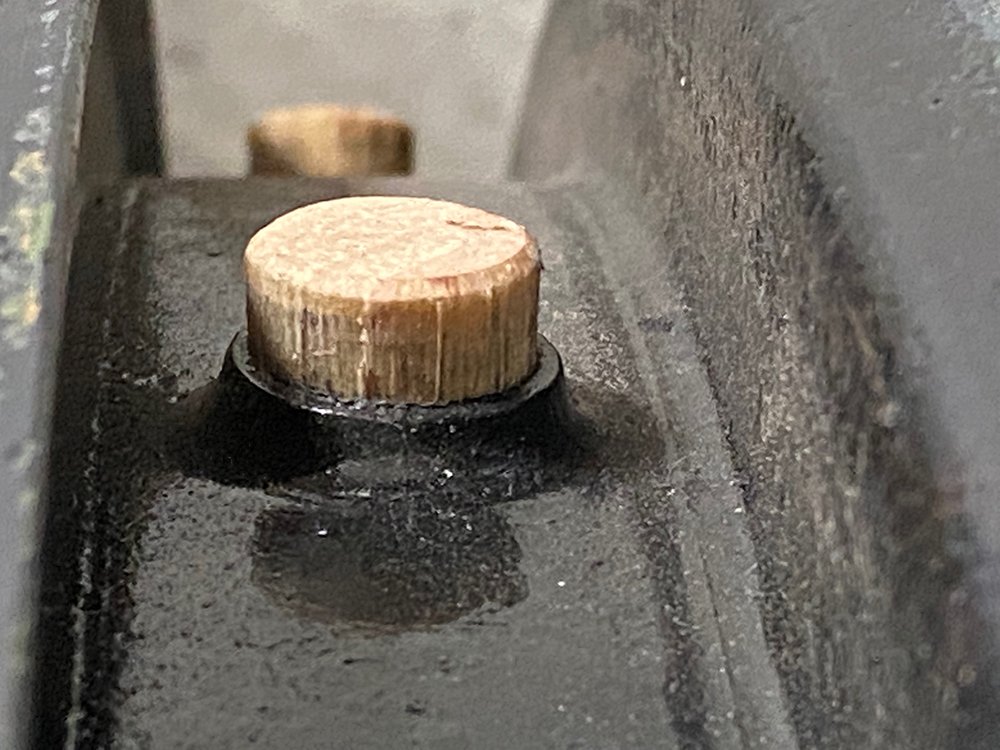

I pulled one of the rims off this weekend and the spoke tenons look good. I have tires, tubes and rim liners coming from Lang's. That will make me feel better to run it around some more to figure out what needs done and I'll inspect the rest of the tenons while I'm at it.Oldav8tor wrote: ↑Wed Jul 05, 2023 8:37 pmAnother thing to check when assessing the spokes - with the demountable rims removed, look at the conditions of the tenons (the part of the spoke that pokes thru the felloe.) If it looks like a wart, it has been compromised and the spokes are on borrowed time. A good whack on such a spoke sheared off the tenon as shown in the first photo.

My son and I changed the tires today. Someone requested that I post a picture of the edges of one of the rims after the tire was removed. Here are the pictures:
When we were pulling the rims off of the wheels we noticed that on the front wheels the ends of the spokes looked like this: and the rear wheels looked like this: Is this how it's usually done?
- Posts: 6605
Re: Newbe 1919 Touring Questions
things look to be in remarkably good shape
you will find on that one front wheel that what you think are spokes protruding (round) is really just steel dimples in which the spokes have little short tenons simply smooshed into them. If what I say is true, then personally I would take a very close look at the other 3 wheels, take good photos of them and then try to find a 4th wheel just like them (where the tenons go all the way through). Beware that there are multiple versions of "correct" wheels out there so be sure to replicate the style you have
as far as clinchers, the clinch part is about as good as you are EVER going to find on a demountable wheel. You are one lucky fellow!
I cleaned and wire brushed the insides of the rims, but did not paint them. I had my son helping me (or maybe it was the other way around) and I got into "get it done" mode.
Both front wheels had the dimples that the ends of the spokes fit in. Both rear wheels had the spoke protruding through. What should I do to check that the front wheel spokes are OK?
- Posts: 6605
I'd put tires on the rims, the rims on the wheels, the car on the ground, and then pinch a thumb and index finger together such that they are pinching tightly around/against the spoke AND the felloe (at 12 o'clock) and then give a mighty heave with the other hand on the tire (at 12 o'clock) and see if there is ANY movement between the spoke and the felloe as detected by finger tips. Then rotate the wheel and redo for all 12 spokes...you're not worrying about kingpin or suspension looseness so don't mistake movement there with movement BETWEEN THE END OF THE SPOKE(S) AND THE FELLOE.
that tests tightness/fit
structural integrity of the wood is another thing entirely and can be somewhat determined by taking the 6 bolts/nuts off, popping the retaining plate off of the spokes at the hub and going at one or more spokes with a screwdriver and determine if the cellulose still has enough natural resins to hold the fibers together or if the wood has become or is heading towards being punky. Even if good, you're going to scar some wood but the retaining plate will cover that cosmetic blemish.
Let's say, everything's wonderful...ok. Once the felloes and spokes are painted, if you ever see paint cracking at the spoke/felloe interface, don't panic, but keep an eye on things. If you ever see fine red dust creeping out from the spoke and starting to coat the felloe around that area, then that is pulverized rust dust creeping out and now when you do your "shake test" you'll probably detect movement...time for new felloes and spokes then. So if the best scenario shows good old spokes, in the mean time, keep eyes peeled for a matching set of felloes to match the rears.
