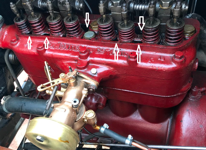

Another possibility is to much oil in the cam cover. You said there is a OHC Montier head. There must be a oil pump to lube the cam. Possibility there was a orifice in a line that fell out flooding the valve guides.
Show a picture of the head/ motor please.

There is no cam cover in this version.
And no oil pump.
