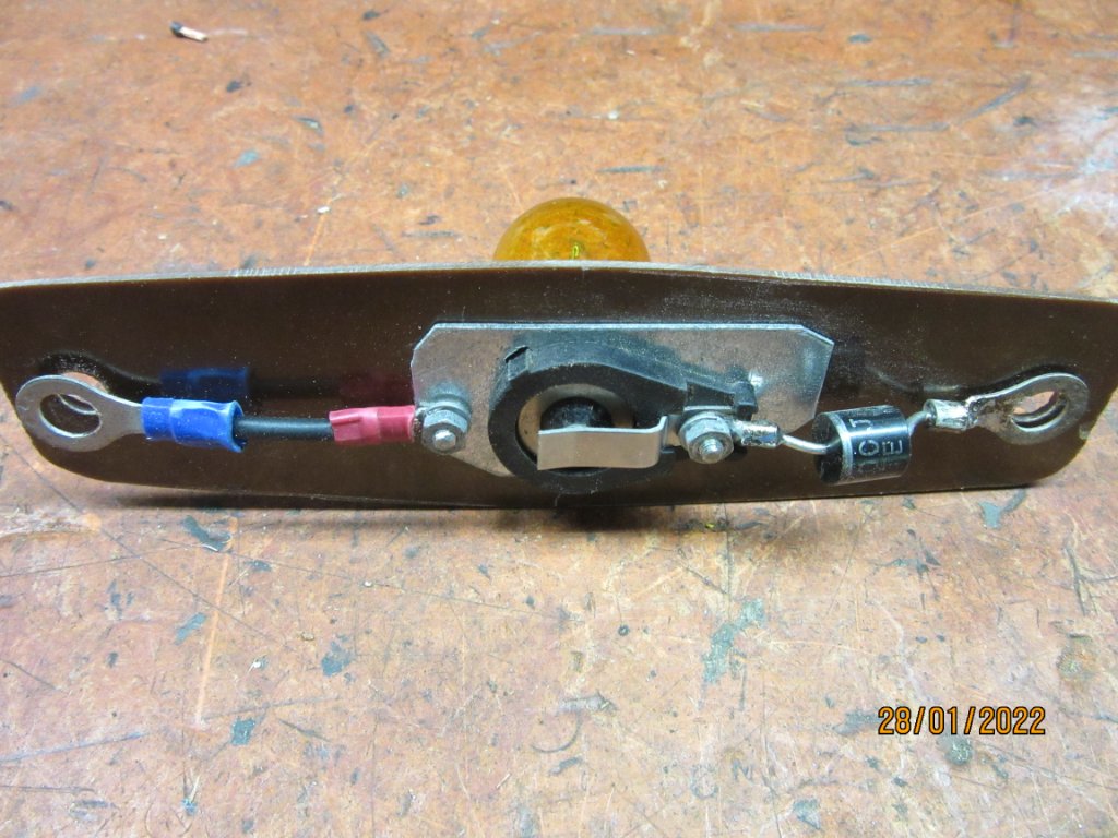

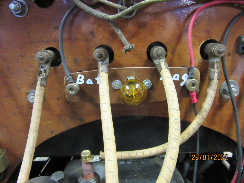

Ron, I made this one thanks to John Regan !!!!
Toon

It appears to be simple to make one. I suspect a diode and a light bulb. Perhaps a mag headlight bulb is needed.
To be most effective the half wave that doesn't go to the coils would be used for charging the battery. For this to work, the magnets have to be oriented in a certain way.
I plan to determine the wave orientation with an oscilloscope or possibly with a diode. Six years ago I believe the coils were positioned on the flywheel to fire when the north poles are adjacent to the magneto coils.

I have a 15 in the shop at the moment, it is fitted with a diode # 70HF60, and no light globe, it's been on the car for years. When I get it up and running I'll check out what it is doing.

I found one. Just what I needed for my new (to me) 1915 Runabout.
