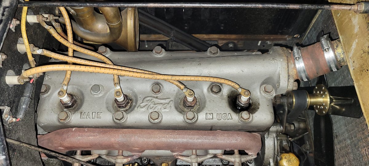

Here is the Reeder head on my 1915.
Here is the Reeder head on the 1911.
At the water outlet on both of them is the number 4.

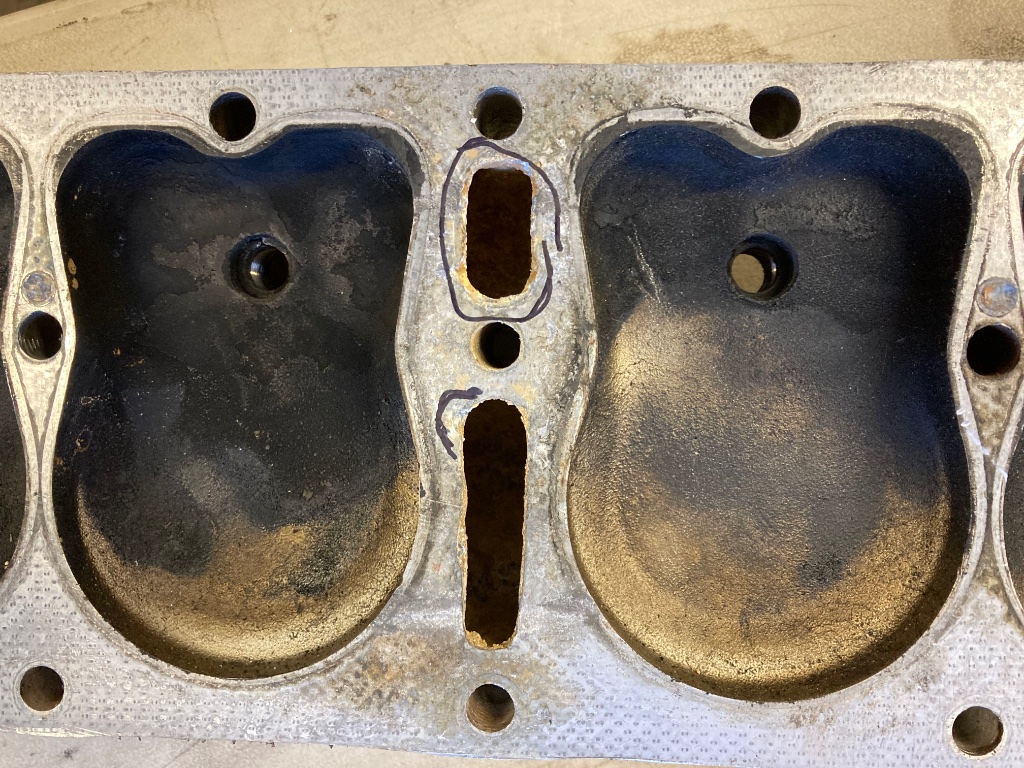

A little late on this thread. I have a reeder head that I replaced due to corrosion. Obviously there was some lack of maintenance but I also have to be a little suspect of the alloy. Someday it might be worth welding up. A sold another in much better shape at the Auburn swap meet for 300 so it will be awhile before it’s worth repairing.

If I was to have that corroded head welded and resurfaced, I would have the large hole between 2 and 3 which has no counterpart in the block, welded shut. Mine and that of a New Zealander required this when both warped between those cylinders. Perhaps that's where going "Going south" originated
Others have not had the same problem.
