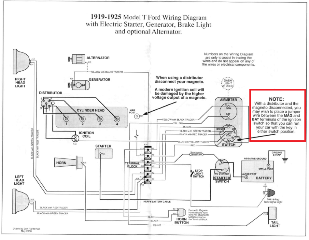

In review:
1: This problem is using your battery not the magneto to run on
2: The engine only stalls when you turn the headlights on...sometimes
3: When the driver's side headlamp is unplugged you don't have the issue and can run all day without any problem
4: The contacts in the driver's side headlamp socket are loose
Have you wired the car per the attached diagram based on your components?
The switch can not be the problem since it controls both headlamps in parallel from the terminal block. Since you don't have the problem when the driver's headlamp is unplugged, the problem must be from the terminal block driver's side connection to and including the driver's side headlamp socket. Like you said.
I wouldn't bother doing anything until you replaced the driver's side headlight socket to see if that's all that needed to be done.

Post by Arbs » Mon Jul 31, 2023 7:03 am
I've been using Ron Patterson's wiring diagram. All the wires are brand new from the switch to the headlight. The only difference in my system is that I've eliminated the horn for now.
The switch is older, maybe original?
Fuel flow seems fine. Carb is rebuilt as well. Fuel tank flushed, steady flow to carb.
When the socket comes in, I'll swap it and test. More to come!

The gremlins are back!
Everything seemed like it was working until it wasn't. I turned the lights on again and the whole car shut down, while I was on battery. I switched to mag and drove home without issue.
Even though it was frustrating, this time the battery side of the car was consistently dead when I turned the lights on, so I could really debug it. I took a multimeter and started tracing the issue from the battery forward. I fully expected it to be the switch.
I went through this process with the light switch off and on...
Battery, good.
Starter switch, good.
Fuse and connections, good.
Terminal block connection, good.
Power to ammeter, good.
Power to switch, good... until I turned the lights on.
Went back to the ammeter, and the post connected to the switch was dead.
Tried it a few more times and consistently the ammeter post would be where voltage would drop to zero when the lights were on.
I swapped out my original, nice looking, ammeter with one of the repro ones the vendors have. Luckily I had it lying around. Now the headlights are solid.... and brighter!
The original ammeter wasn't dead and would display amps while the engine was running.
The headlight socket did need replacing, because the headlight bulb could not make a good connection but I think ultimately it was the ammeter.
With all of the parts going into it, my 1923 car is slowly becoming a 2023 car. This should be the end of my electrical issues... wait, what's that...
