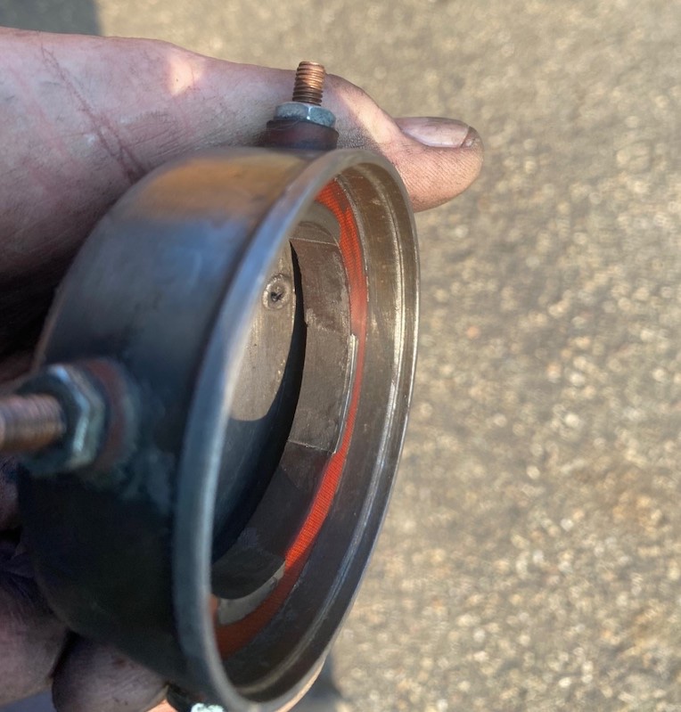

Had the mag post out yesterday to examine the pickup... it is fairly new and looks OK, appears to have full continuity thru the range of pin motion. Connection is solid. Also tried bypassing the mag wiring and switch assemble completely, no change (Video 2:10)

Post by Chris Bamford » Sun Aug 20, 2023 1:01 pm
Good morning all. I see the new video links were a definite improvement.
So, unhook the mag-battery charger they said... examine your timer they said... swap in some known-good coils they said...
The mag-battery charger was easy: it was already off and had only been a tool to indicate magneto output. I have a set of known-good coils in my '26 Touring (also set up on the FACT) but the Speedster coils are tucked up under the cowl and awkward to access. The easier task was to swap out the TW Timer with my backup roller timer.
Turns out they were right!
I found significant oil inside the housing (perhaps the cam seal is failing?) and obvious schmears of oily carbon residue around the contact ring. I cleaned this timer only a few hundred miles ago and it was reasonably dry, so something has changed.
First photo is the TW partially cleaned but showing definite greasy carbon tracks between the contact segments. Second photo shows some pitting/erosion on the timer ring contact segments and extending into the insulation.
The engine performed as expected with the roller timer: RPMs picked up a little on MAG and the magneto voltage tracked RPMs nicely. Magneto voltage is well over 30 VAC at speed for both BAT and MAG. Rough running on MAG is gone. I assume the oily carbon schmears in the TW shorted out the high-voltage/rpm magneto current and jumbled up the timing.
Not out of the woods completely though — I'll have to sort out that oil in the timer housing (or switch to a roller) and I've been in touch with our club master machinist about cleaning up the TW Timer contact ring.
Thanks to everyone who took an interest and offered assistance... particularly Pat M and also Scott C. Much appreciated, my friends.

I'm glad you isolated the problem.
It seems far-fetched, but I suppose the higher mag voltage was able to ground randomly through the goop in the timer.
If it was poor contact in the timer, I'd think the magneto would have done better than the battery.

Looks like the unevenness worn into the plastic between the segments caused the roller assembly to bounce during high speed. You may want to consider a new commutator. Your present commutator possibly could be turned in the lathe to take down the high spots to match the worn areas.

Hi Robert , I have had that problem with roller timers, and is a reason I avoid them.
The subject timer, though, is a TW with carbon brush with no roller, despite the wear pattern. IIRC, Tony Wiltshire attributed the pitting etc to minor arcing from the brush, at both the point of contact and the point of disconnect.

When you get everything back together and the oil intrusion stopped, running on magneto as much as possible will probably extend the life of the timer.
I'd check it every 100 miles or so for a while, just to be sure it's staying clean and dry. If it stays clean, extend the run periods.
Properly adjusted coils will also help keep the timer in good condition.
A problem with coil adjustment, even on just one coil, can ruin a new brush type timer in very short order.

The problem seems to have been oil intrusion causing timer issues.

The carbon/oil "paste" was the problem manifesting @ the higher mag voltages.
Lesson to learn : when running a brush, have a good oil seal to keep the oil out. (like a new day)
This failure can also happen with a roller brush. The conductive "paste" is from worn metal, but takes longer to build up than carbon.

Had you not said it was a TW sideways brush timer, i would have suggested the timer housing was one of those ‘oops’ of some 15 years ago on a repo Tiger where when there was roller bounce, even in the slightest, the plastic wallowed away when it reseated and caused very erratic operation.
Convince yourself it is smear to continued ground and not a wobbbly cam end. Good old Royce use to advocate filling the timer housing with non conducting grease. I did that in one and other than taking a little more to get going…has been flawless for years. I got around the start by dry cranking a few turns before ignition attempt.
