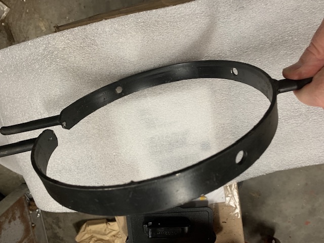

These were made by a couple of our forum members a few years back. Work great!!!!

Look in the Service Bulletins. You will find the tool like I posted and later the tool Dan T showed.
Also the Ford Owner and Dealer magazine had some great ideas for how to things on the T.
Remember, someone 100 years ago was trying to figure out how to do this stuff too. And with a lot less than what we have now. Dan

Checking Lang's catalogue, I see only the tool Dan Treece posted. Preferring the other type, I made mine hinged so it comes apart to fit in my under-seat tool box. Used properly it gets a good, solid grip on all four rivets.

I like Dan Hatch’s post on a great homemade tool
that surpasses the ones that the venders sell. I have one of those. I just need two more hands and I will be able to get the job done. Thank you all for the great thoughts!

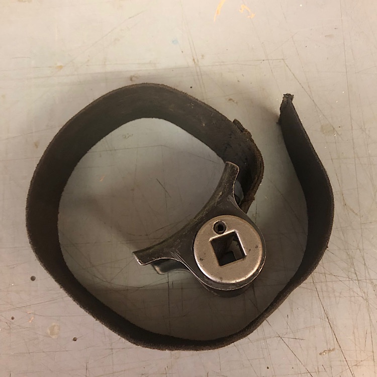

I had trouble getting the rim on my bucket. I got this strap wrench at Home Depot, Husky brand. Super soft, I just got the car painted. On and off with just a pop. It has a long strap, 34 or so inches. I think it was $25 or so.

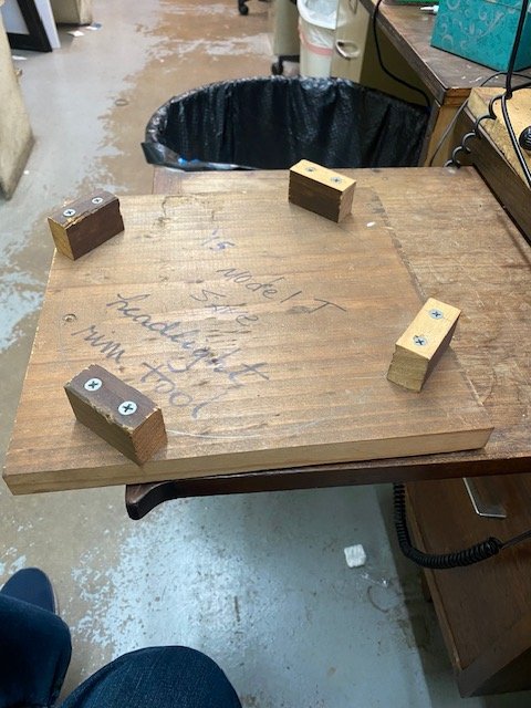

I made mine out of wood. The blocks catch each rivet. You simply push and hold some pressure on the base, and twist it, and it releases the rim on my 1915 every time, with no scratches or damage.

Dan Hatch wrote:
Fri Aug 25, 2023 10:40 am
Yes they work great but a bear to make. Time and materials made making many for sale not profitable for what people would pay for one. We made a few and just gave them away to friends. You were one of the lucky ones!
