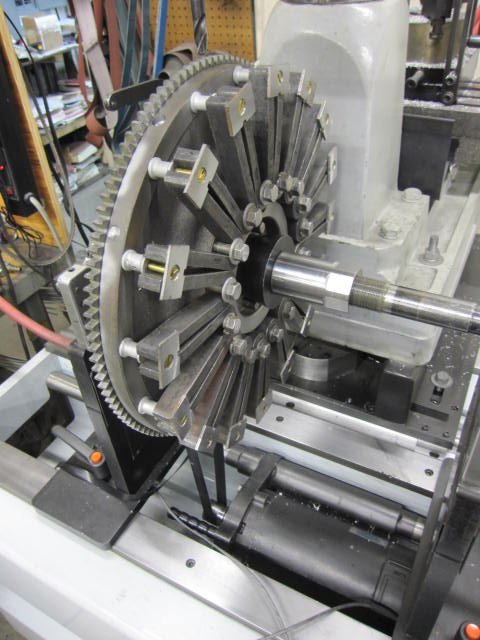

Post by J and M Machine » Fri Nov 03, 2023 5:34 pm
Rich P. Bingham wrote:
Mon Sep 04, 2023 4:32 pm
Refurbishing the engine for my '13. By matching heavier pistons with lighter connecting rods, weights vary 9/10 of an ounce, 1/2 oz., and 3/10 oz. over the lightest pairing. I suppose it's possible to have them weigh up equal, how necessary is that ? What do experienced T engine rebuilders consider to be an acceptable difference ? Running cast iron pistons if that makes a difference.
It's important if you want the engine to run smoothly and biggest improvement you can make is balancing the flywheel.
The rods have to be weighed end to end to find lightest then all others should be made to weigh same amount.
Same goes for total weight of rod and piston weights. It will be big improvement on how engine runs.
Doesn't make a difference regarding balance if they are cast iron or aluminum, in aspect to balance them.
You can see in pictures what it takes to do the pistons and crank and flywheel.
From previous posts others have posted from past you cans see how we did rods.
As I 've mentioned it makes a big difference in how the engines run.
These engines were built with a designed tolerance of balance ;however 100 years later and how many mismatched parts/rebuilds later have caused them to run poorly.
