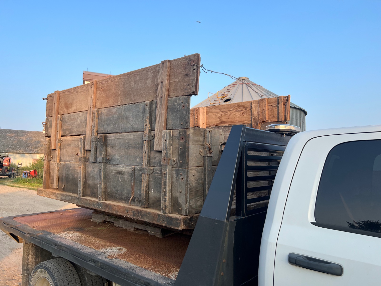

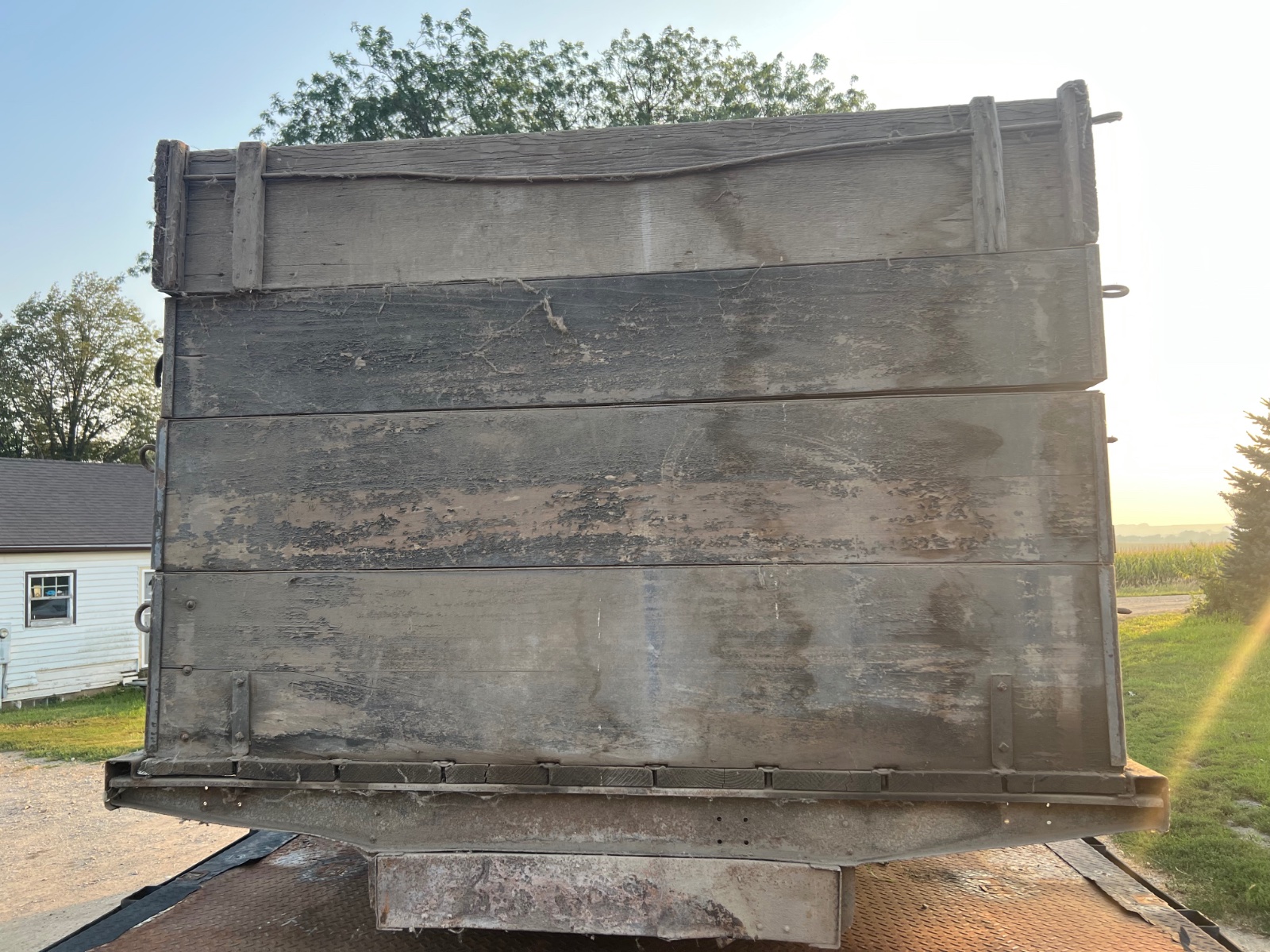

Hello,
I'm new around here but just recently came into possession of an interesting truck body that may be of value and interest to this community.
I have been working on a Farm/work truck project resurrecting a 1960 Willys Jeep truck. It was a factory Cab Chassis which is how I found it in a Junkyard. I have been seeking some sort of body to affix to it and came across this old body from a farm in southwest Iowa.
As you can see it is a Ford body. Based on dimensions it is a Ford TT flatbed body, 8.3 feet long and a little over 6' wide. The long sills are about 32" apart and it has the "Food Truck" script embossed in the rear plate. By all the information I can find it is clearly a TT body dating no later than 1929.
I was, however, not having any luck IDing the body which did not seem to match up to any of the builders known to produce ford factory grain tanks.
After a lot of searching and google fu I was able to identify the body as having been built by the Badger Body Manufacturing company.

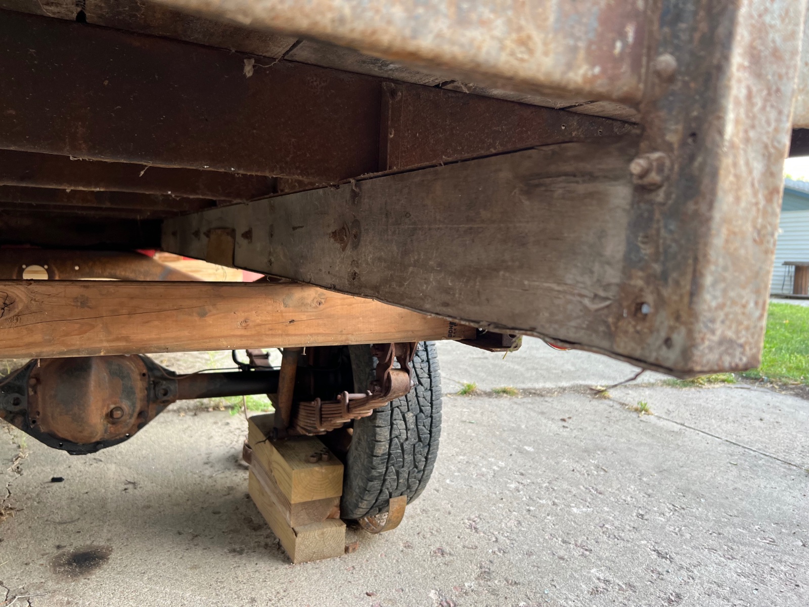

details of body

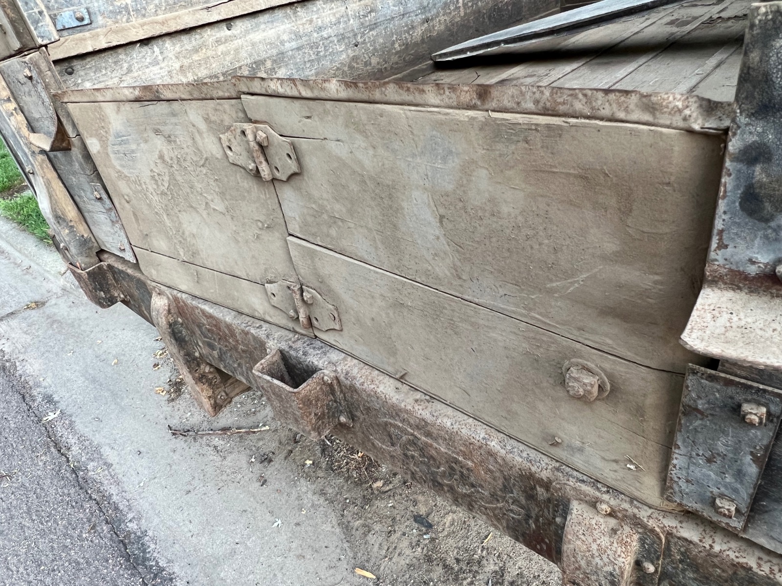

More Details

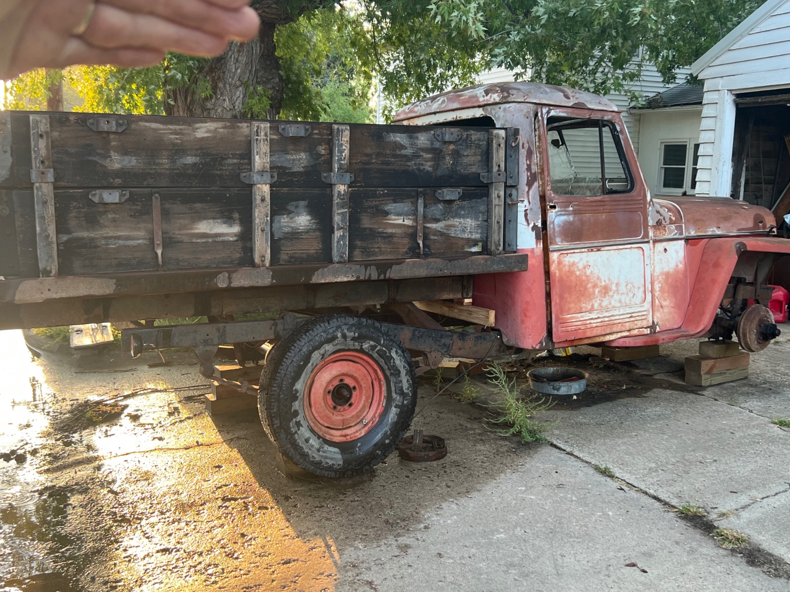

washed out top tier removed

I will begin with some info. TT truck production ended in 1927. From then on it was AA trucks. It appears that you have a TT or AA Stake bed with wood floor. The grain bed MAY or may not have been original to the truck. The upper "box" is a Grain bed addition which appears to be a conversion from Badger. I say this based on a farmer may have purchased the truck as a flat bed, stake panel bed, or specifically to have Badger build a grain bed for it. Being able to multi task would have been a big benefit for a farmer.
Value, the same as Beauty, is in the eye of the Beholder. To you, or me, it has great value as a grain bed. To others, the stake bed is the valuable part and the upper is just trash. As to the price, as with all old things, it's worth whatever someone will pay for it. You should look up Dallas Landers on this forum and look at the bed he MADE/restored for his TT, absolutely outstanding. The only 8 in 1 operational I have seen, and worth a mint. I believe the bed to be later as you spoke, which the steel bed indicates. Mine is a 1920 with the entire bed being made of wood, upper and lower. I believe yours to be later than 1925 as I have seen a 1925 stake bed with wood stake panels, exactly like yours. I do not know exactly what year Ford began the stamped steel stake bed option.
What to do with your bed. It appears to be in great shape overall. My grain bed is a hand crank dump type but I have seen non-dump grain beds as well. You could complete the hardware, replace damaged/rotted wood, and mount it on your truck. I believe it would work well on a TT or an AA. I am not sure how well it would work on the truck you pictured it on. Frame strength and weight distribution being of prime concerns. IF it is just for display, I think it would be fine. BUT, if you plan on actually loading it with anything, it might be a problem. As you replace hardware, you might look for one or two chains that run from side to side, at or near the top of the sideboards to hold the boards together so the weight of the grain did not push outward and break the uprights. I'm sure you will be able to find photos of the inside of grain beds on line.

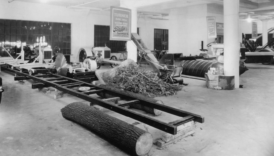

Jason, you have probably seen these photos of the inside of that Badger building. But I attached them for others to see too.

Thanks for the reply, I looked at all kinds of references on these flatbeds and the Embossed "ford Truck" logo combined with the 32" spacing seems to indicate its for a TT. The later AA bodies looked very similar but they all had a Sill spacing of 42ish inches from what I could find.
As to future use, the truck Im working on is mostly meant to be a funky old truck for tooling around picking up or delivering projects, transporting lumber or gardening supplies etc. I do not expect it to see any real heavy loading. Its kind of a rat rod farm truck with all the patina and parts that conceivably
might have been available in its time. I could certainly see an old bed getting shuffled onto a new chassis every couple of decades.
Condition wise the entire things is in sckingly good condition. there is surface rust for sure but no rotted holes in the floor and the uppers are near perfect except for some cracks in the rear door panels. as you mentioned cross chain wise, in some of the pictures you can see that when I got it an additional tier had been added on top. the skewer(for lack of a better description) across the front boards matches the others on the lower tiers and there was an additional full length board for the top tier at the back. so I suspect that was the original configuration for the body.
there are some dents but really no perforating rust anywhere.

As you say, the body is not ideally fitted to the jeep. I have been debating different paths for the bed. one possible would be to reproduce this body at a slightly shorter scale to preserve this piece or perhaps sell on to someone to complete their project.

Jason, One viable option is to take OFF the grain bed. Then you would have a flat bed. It would be pretty easy to slap some lumber together for stake panels. Then you would have all sorts of options: flat bed, stake sides, 1 board level box, 2 board level box, 3 board level box, or full grain bed box.

The "skewer" or cross tie bar, were often hand made by a blacksmith. I'm sure you could find a blacksmith close to you that could make copies. Most of the hardware on my bed looked to be hand made, but, then again, there was the distinct appearance the whole bed was hand made or at least NOT a product of a true carriage company in 1919-1920. If mine had not been left out in the weather for the 95 years before I bought it, it might have been in better shape. IF I remember correctly, I had 2 cross tie bars in the front and 2 in the rear.

Did Badger make the “Snow Tractor “ ? I see one in the showroom pictures. Dan

Dan, the sign in the back of this image says "Snow Motor" at the top and "Authorized Distributors" at the bottom.

Armstead Snow Motor. There's a promotional video on YouTube showing one in action. Towards the end of the film, it also shows the attachment installed on a Chevrolet Superior Touring Car.
