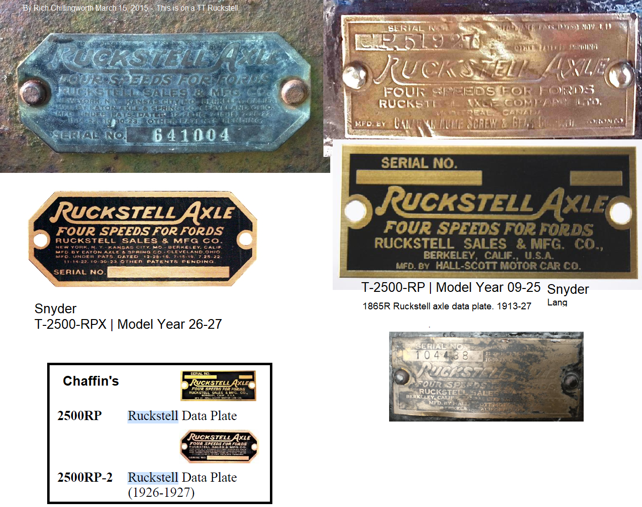

I'm rebuilding my Ruckstell and the data plate was obliterated. I have the right replacement but can someone tell me what size the serial number is so I can get the correct punches?
- Posts: 6581
Re: Ruckstell Data Plate
Looks like any may work
Susanne
- Posts: 1119
- First Name: Susanne
- Last Name: Rohner
Upper left plate is the one I see a lot, the lower right (earlier) is similar, but they both have the same "number font" as the 8 sided (later) one.

There are at least two versions of the common retangular data plate, early and late. The clipped corners plate was introduced when Eaton took over the manufacturing of the Ruckstell's. It can be found on small drum Ruckstell's as well as the big drum models.

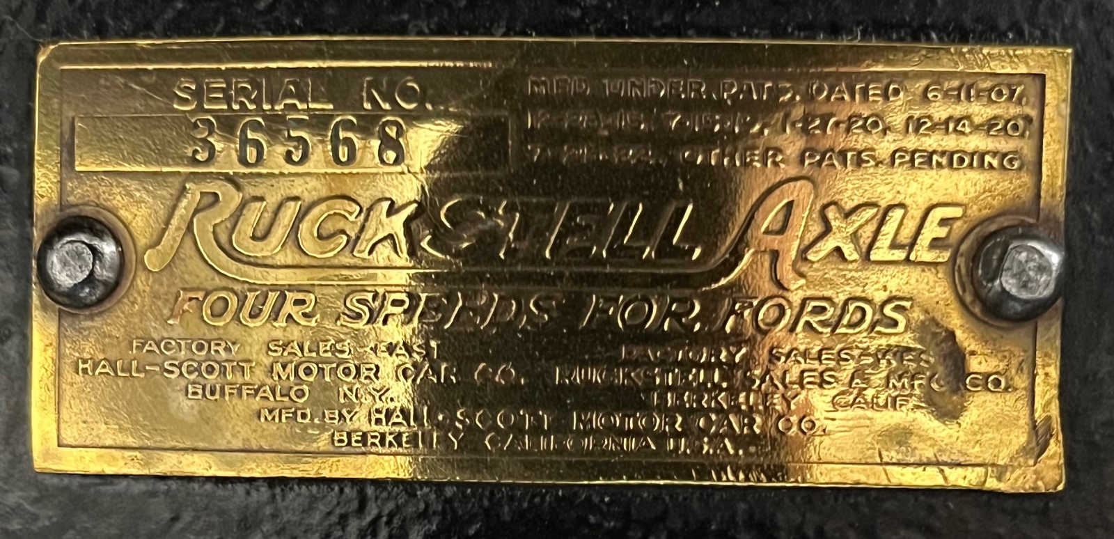

I believe my Ruckstell is a fairly early one; it has the early brass shifter housing. The numbers on my tag are 0.10” tall, and from the left side of the 3 to the right side if the 8 measures 0.50”. While the numbers are not “perfectly” aligned vertically, because they are not rotated and are pretty evenly spaced I tend to concur that some type of fixture was probably used for alignment.

It is a 3/32 stamp.

The font type is called Benjamin Franklin.
