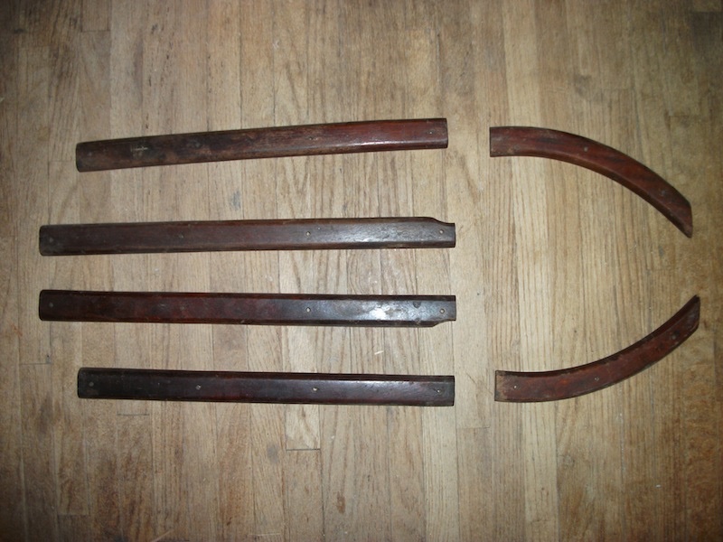

I can probably get them made by my brother just need to show him a picture

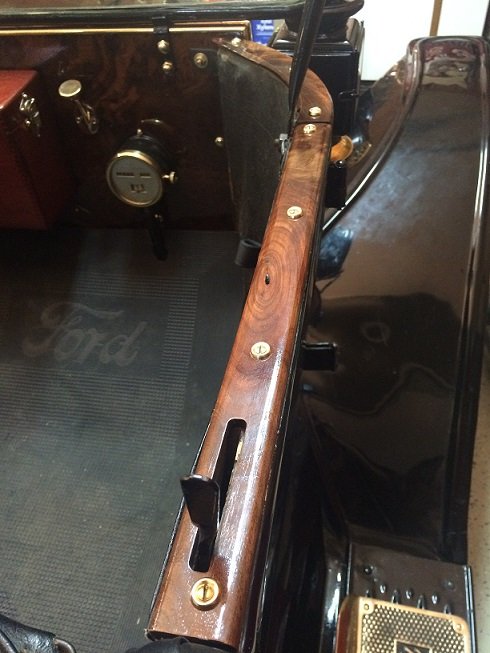

Re: Wood mouldings on model t's
They are simple to make. Take the old moldings off to use as patterns. Then re-saw mahogany, walnut, or other hardwood into thin strips. Trace the outline and details from the originals, Cut and finish with spar varnish.

Thanks for the picture Mike.
