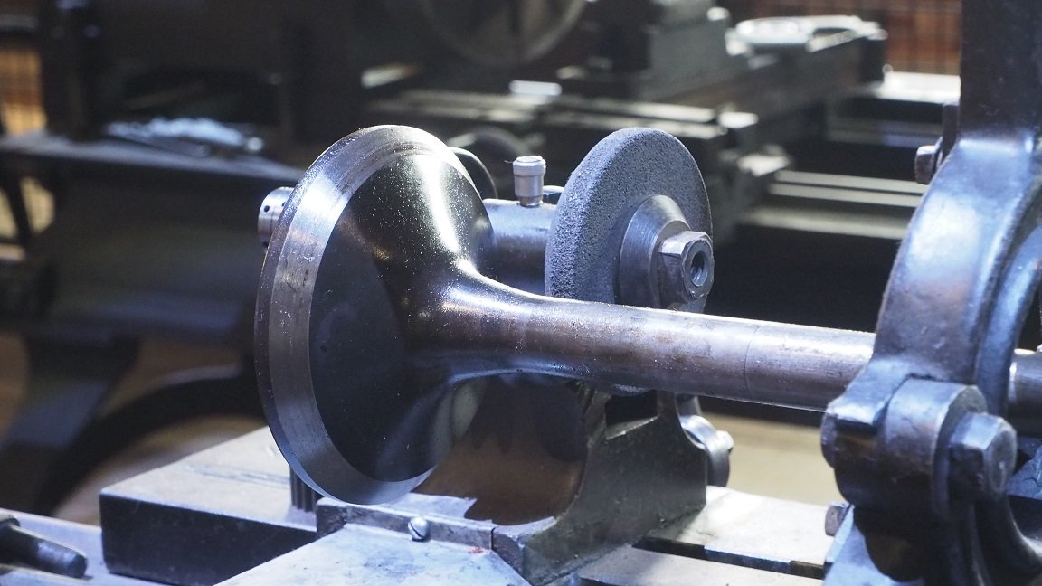

Hope this is OK Ken. I really like the shop you toured and your two pics of the HUGE engine valve in the lathe with another grinder are really neat!

The other thing that caught my eye in the machine shop was the drums on the planer.
They reminded me of the drums in a model T transmission.
2 drums turn one way and the other 1 turns the other way.
The lever automatically slides the belt to the other drum at the end of the stroke.
This is the first planer that I have seen in a museum that was working.
The other ones I have seen were missing parts and hard to visualize exactly how it worked.
