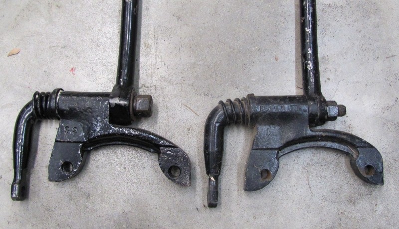

Have two of that first kind, one has the nicer splined shaft, the other is square shaft.
The spine is nice for getting the shift arm where you want it!
Spline shaft on right:

The square shaft one may have been a modern reproduction. I had one and it never fit right.

Square shaft was regular until Eaton bought out Ruckstell, according to Original Smith which introduced the splined shifter - hope I got that correct Larry !
