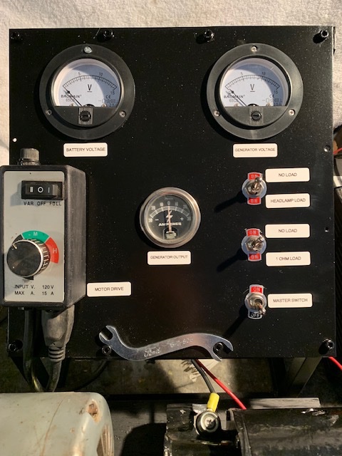

I rebuild generators and have a bench tester I made to quickly diagnose issues. I can walk you though a few tests if you have a basic voltmeter.
Shoot me a message if you want to take a few measurements.

UPDATE:
I sent the generator off to Chris Mize and they put it on their bench spinner and was able to set the null point. I just installed it today and it’s working fantastic now.
Travis Towle

Moxie26
Posts: 2066
Last Name: Jablonski
Location: New Jersey
Re: Amp Meter discharge, but no charge?
Post by Moxie26 » Thu Dec 07, 2023 9:59 pm
Good news Travis... !
