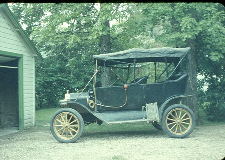

In this picture of the car from 1912, you can see fairly clearly there was no flap. I see the top straps running right to the front bow. Even though the car is 16 years old in this picture, what are the chances that piece was removed?

Darren J Wallace wrote: ↑Sat May 25, 2019 9:07 pmIn this picture of the car from 1929, you can see fairly clearly there was no flap. I see the top straps running right to the front bow. Even though the car is 16 years old in this picture, what are the chances that piece was removed?

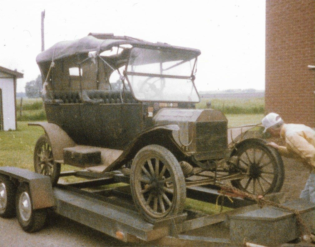

This photo from 1989 shows the original rear window

Hello my late 12 Canadian car does not have the flap and never did , the original top was replaced in 1967. The original top is in the garage in a box.

Don't forget, the front bow doesn't use bow drill. It uses top material, and MUST be installed on the bias. It is really a job to get it right, and uses quite a bit of material. I've found a heat gun, and contact cement help a lot. Expect sore fingers too. Next, I can't imagine your car having a rear window as small as the one in the old photo.

As other have said, there is no windshield "flap" for 1913. And I understand and appreciate the fact you are tying to do an authentic restoration of your family heirloom. However, there is no reason that you could not fabricate a removeable windshield flap. I have considered it for my Oct-Nov, 1911 car, but to date has not come to fruition.

By the way, I love the rear section of after market side curtains in your 1929 photo.

Larry, thankfully, Clastique's great top kit has a better sized window! Everything is going fairly well and yes, I have no finger pads left!
