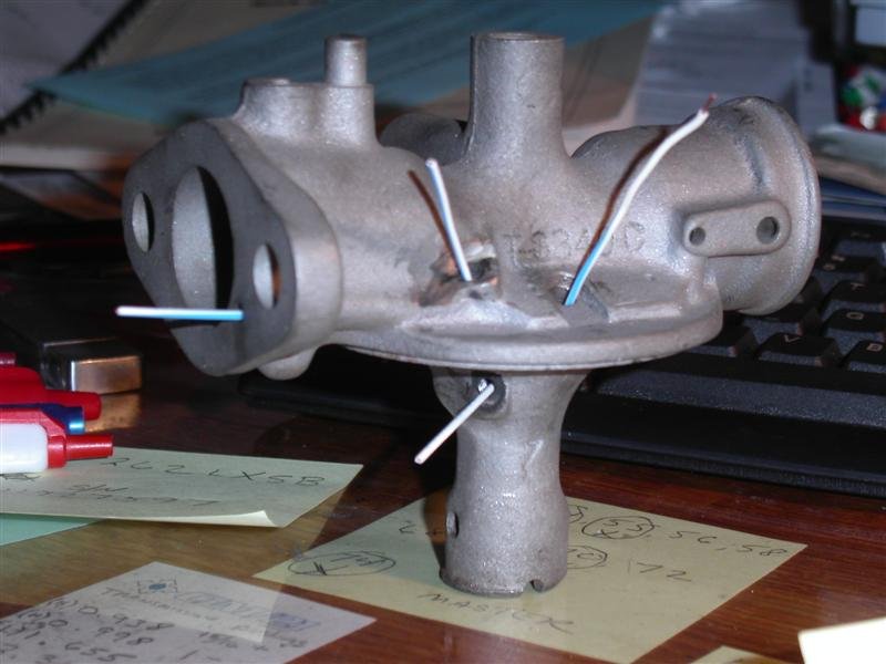

Mark Nunn
Posts: 1241
Last Name: Nunn
Location: Bennington, NE
Re: Cleaning NH Carburetor
Post by Mark Nunn » Wed Nov 01, 2023 1:20 pm
AndyClary wrote:
Wed Nov 01, 2023 9:18 am
You can plug the passages back up with soft brass like brazing rod.
Andy
I did not have brazing rod but my hardware store had brass screws. I cut pieces from the screw shank.
