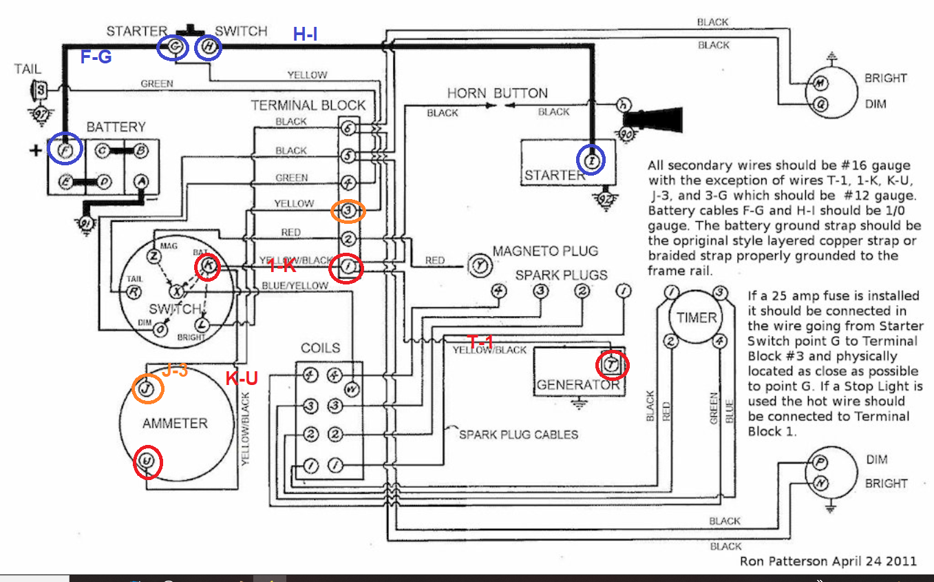

This one of the best wiring diagrams. The J position on the ammeter is for the + positive connection to the BAT position on the ignition switch & the U is the - negative position on the ammeter from the cutout/VR on the generator via position 1 on the terminal block.
Some ammeters connections aren't marked so its up to the user to figure direction
