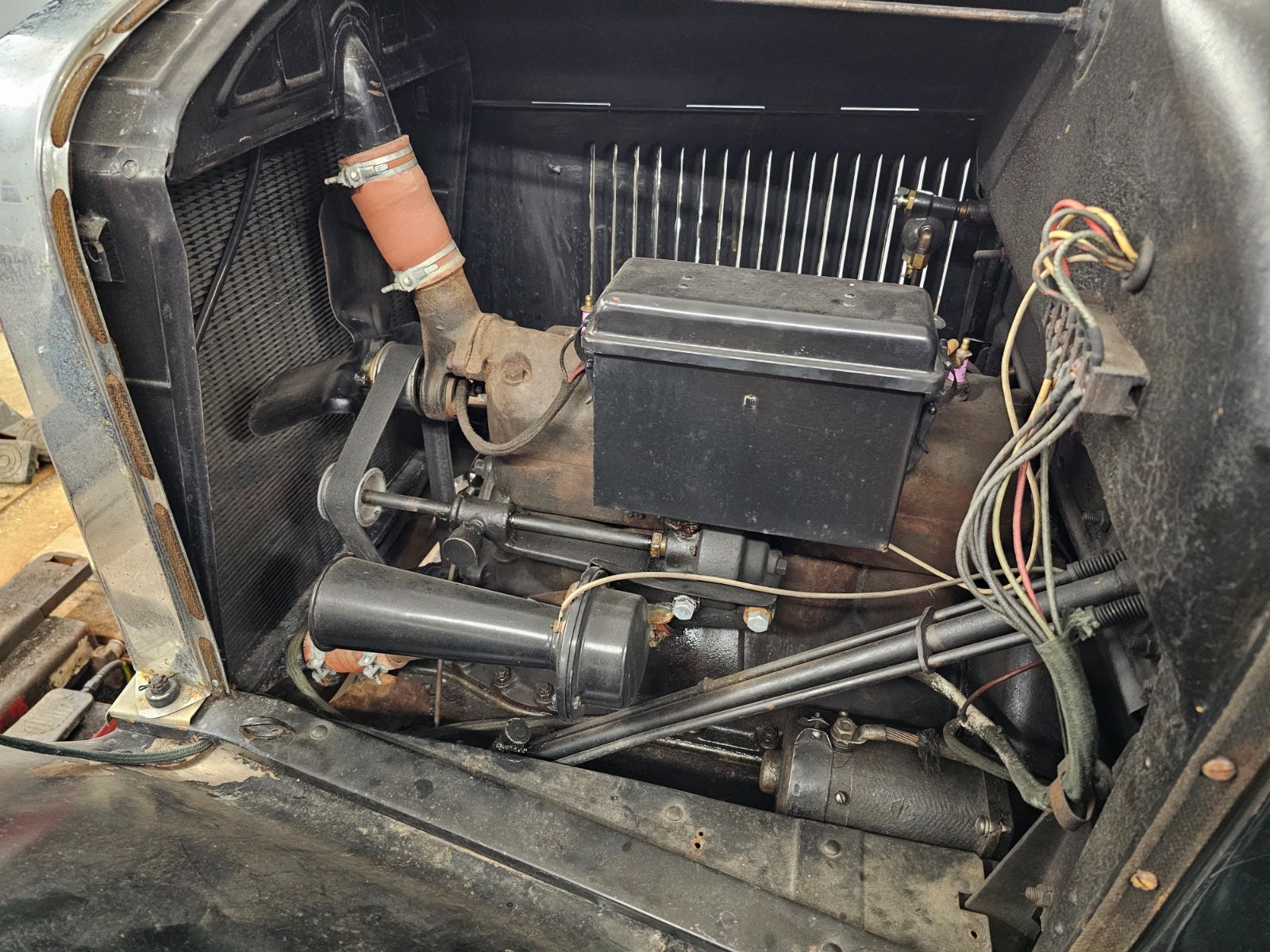

A slow battery drain in a T is unusual. Assuming it has a stock electrical system with no added electrical accessories, about the only thing likely to drain the battery with the car sitting is the cutout relay on the generator, and if that sticks shut, it will very rapidly drain the battery.
The battery itself may be the problem, or dirt on top of the battery.

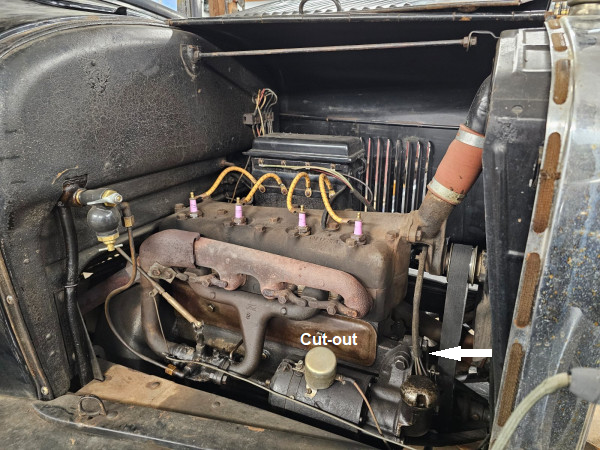

That little gold can is likely to be one of those cheap repop mechanical generator killers.
Get a diode cutout before it fails. It could be the source of your current draw.

You said that the car had been in storage since 1987, but you didn't say you replaced the battery. Did you?
Your spark plugs, if Firestone Polonium, are somewhat of a collectors item. I'd save them for a show Best price on new spark plugs & wheel bearings is RockAuto.
A cut-out is just a simple switch. If the cut-out contact points were sticking when the engine was shut off it would cause the generator to try to run like a motor - think you would notice that. It does not prevent the battery from overcharging. If you are thinking of replacing it get a Voltage Regulator instead. These are made by the Forum administrator - negative ground https://modeltstarters.com/product-cate ... s-cutouts/

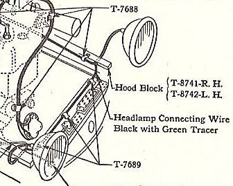

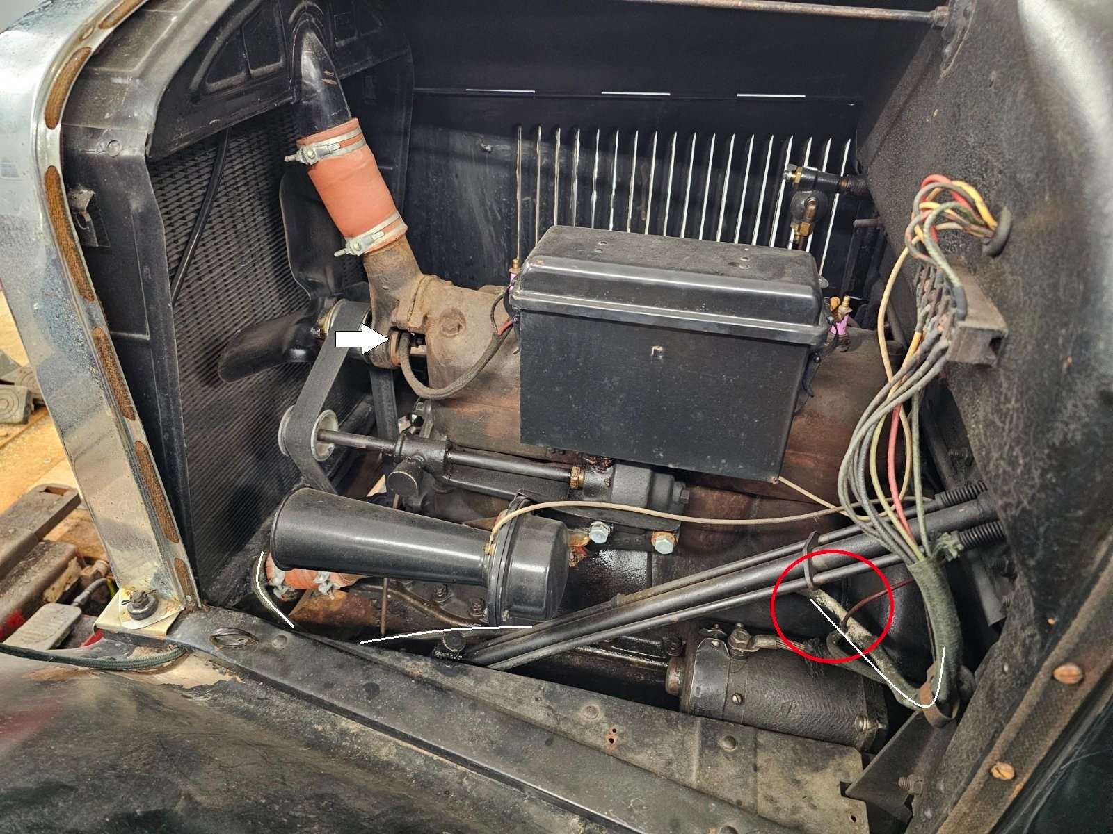

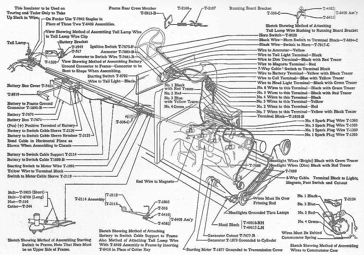

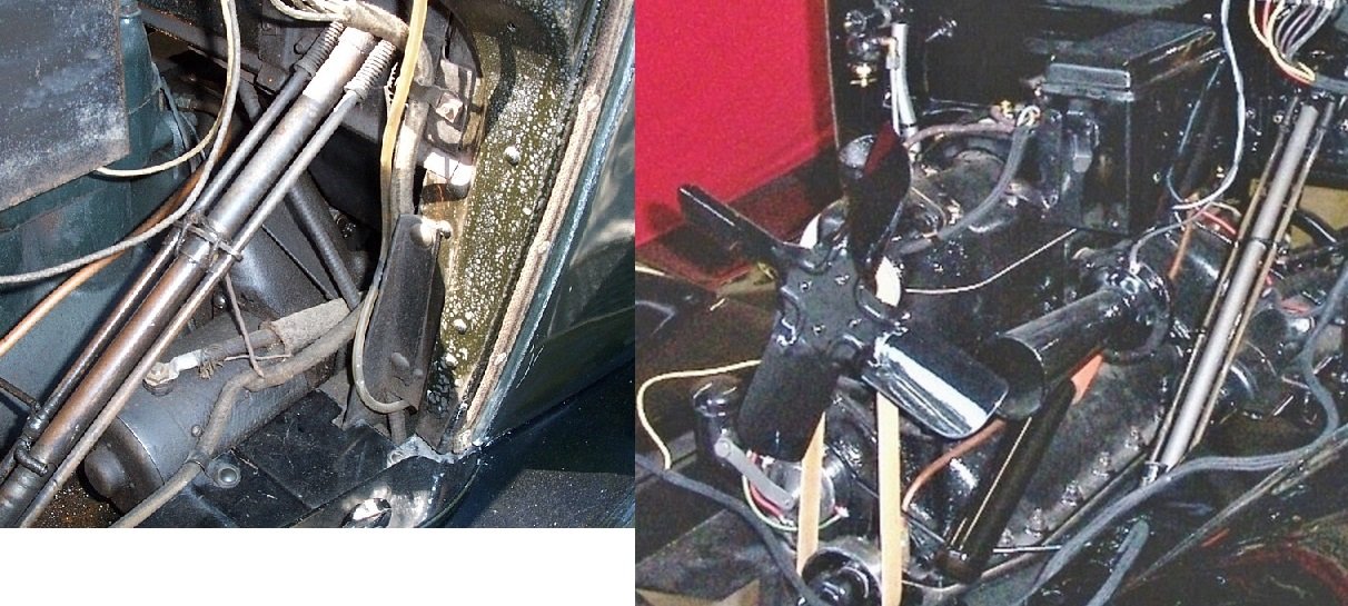

Your wire routing in the engine bay needs some securing also the white area on the harness needs to be investigated.
p side.png (532 KiB) Viewed 6809 times
note white tracer I added of wires going to headlights
example
routing

If the cutout was closed, the generator couldnt motor still bolted in the motor, but it would get hot.
That you could notice.
