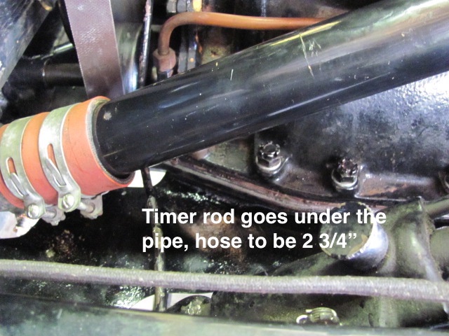

The outlet hose in the kits is normally too long.
Cut it to the factory spec of 2 3/4" length.
That way the end of the hose is well away from the spark rod as it clears just the metal outlet pipe. Too long a hose there can interfere with the spark control.
