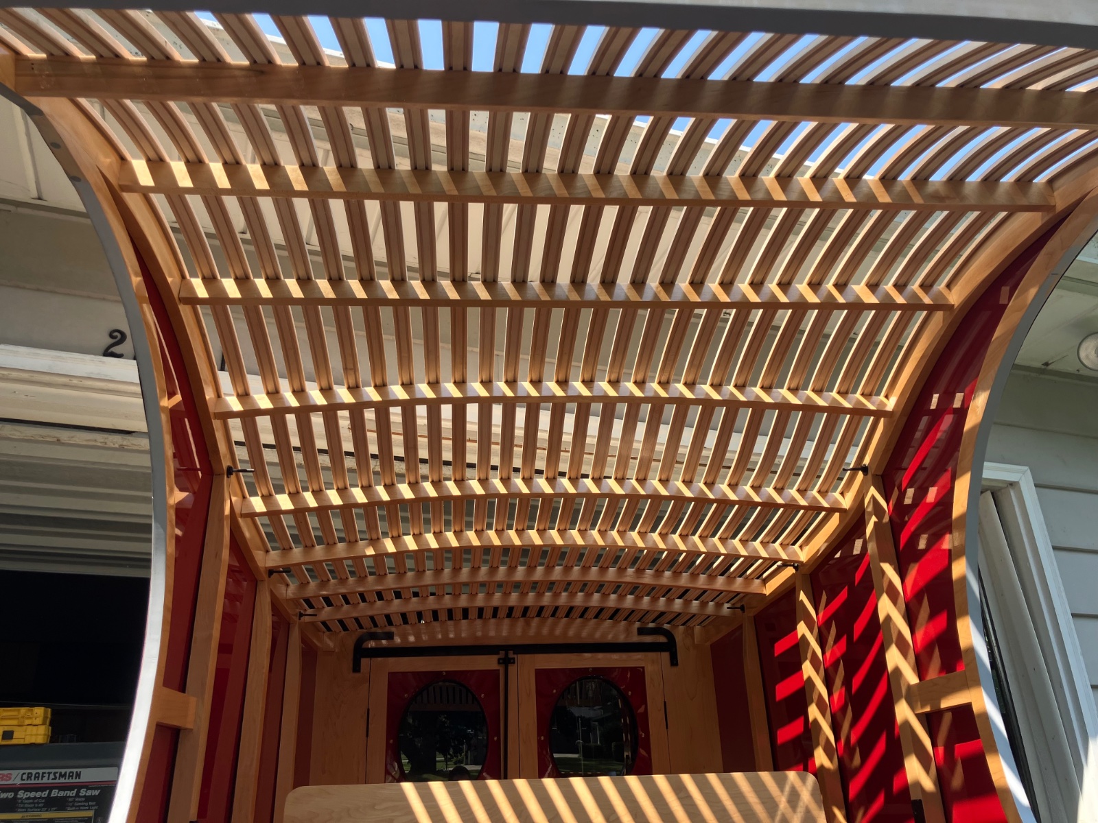

Well, after some months of planning I’m getting closer to getting the steam bending project rolling
I had to make a crude steam tube… being on the cheap side I sourced secondhand metal gas can and Coleman stove. I used old cabinet doors to hold the steam tubes.
I found an old work table someone was throwing away so I could mount the jig to.
I also had to figure up the spacing of the roof slats so I could make up a spacing jig when I go to fasten them to the top. I opted to do some beading on the roof slats that will give it some nice details. The original delivery car that John Regan has shows that detail. A few more steps will be involved in making them but I think it will be worth it. I’m testing out the jig for shape… really trial and error till I get it right.

It’s starting to get cold here in IN which means I need to start working ahead when I can to stay focused and keep the end goal in sight. Tonight I started laying out some patterns in poster board for the metal skin. Also figuring out how all the exterior moldings intersect and cover the metal seams.

Mike, if the steam bending does as well as my attempt, I wish you luck.
On a New Zealand tour I was given a wonderful visit to see a craftsman at work bending wheel felloes. Rather than steam, he boiled the hickory blanks in a section of roof gutter, fuelled by a wood kindling fire. It was a soft as butter to see. His former was mounted to a tree stump still in the ground. Once the blank was bent, a dipper of cold water was applied and the bent timber clamped in an old rim to hold its shape until it dried.
If your steamer does not work well for you you might give his method a try.

Mike the really interesting bit was the spring steel band used. One end was fixed to the former
The supple blanks were butted up against it. Then an adjustable stop was fixed hard up against the other end of the timber blank.
This meant that the outside of the curve was fixed and the inside was the under compression.. The result was there was no breakout in the outside of the bend, critical for a strong, neat bend.
So simple and effective.
Allan from down under

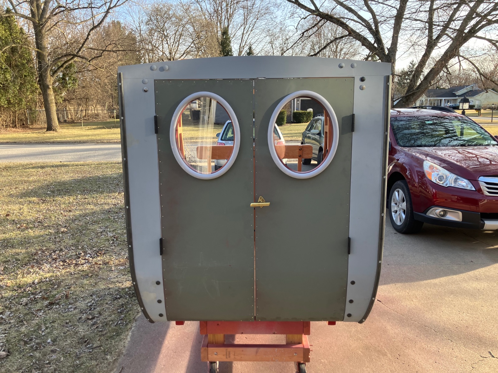

Was able to get some more details done on the rear doors:
Mounting the rear window frames was quite the job today. Very happy with the results. Next project will be getting the moldings that go around the perimeter of the doors cut, shaped, and drilled for mounting.

Look great. I hope that big C is laminated or it is very likely to break anywhere the grain runs across the piece instead of along the length of a piece.

Did you make the oval window trim? If so Id be interested to know how you did that.

Richard,RGould1910 wrote: ↑Sat Sep 07, 2024 9:38 amDid you make the oval window trim? If so Id be interested to know how you did that.
Yes I did make the window frames. It was a nightmare trying to find ones. Oval frames are not as popular as they once were. I did find a company in CA that made frames and I asked if they were wood they said yes. I ordered a couple and upon arrival they were MDF… so I made a CAD drawing and cut them out using a CNC machine. They are 11x14 and made to the dimensions of the glass drawing for the delivery car.

Re: Delivery Car Project Build
Had to rethink the rear door/windows.
Originally my plan was to use two oval frames one inside and one outside with the glass and metal sandwiched between. I then was able to find a high resolution image of a delivery car with the open doors. The image showed that the metal was pushed in to form an oval flange on the inside. The oval wood frame was then simply screwed onto the metal from the back side.
I tried my hand at hand forming with a buck, but it was a very poor job, so then I made a die using 3/4” plate steel and used my friends hydraulic press. I quickly realized that the die needed to be beveled as the material was being pushed out and ended up cracking in a few areas. Only took about 5 tries to get it dialed in, but the result was fabulous.
Was able to make some more progress with the rear doors and moulding. I know it may not seem like much, but getting all the gaps even for the rear doors was important for me. Now that I’m satisfied with the gaps I can finally move onto steam bending the roof slats!
Started steam bending some of the slats to get the roof squared up. Everything worked as it should! I’ll have a video of the process soon.
Thanks guys for your input and encouragement!
Made some more progress with steam bending the roof slats…Had 3 of them split on me in a row. Only 9 more to go!
Finished the rest of the roof slats today. I’m really excited to see the finished product of the roof slats after I stain and varnish them.
