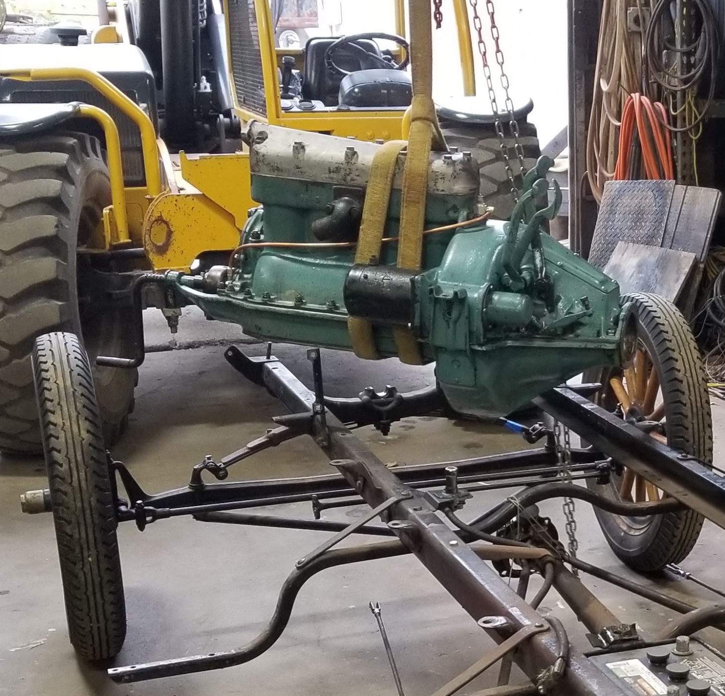

I just use a nylon hoist sling and make a basket loop with it- its adjustable and works just fine. Around the bottom of the pan and pass one end thru the loop and ready to lift. Of course it saves me a trip to my tool box to grab my spark plug with the hoist loop in it. Either way works for me- aluminum or cast iron head.

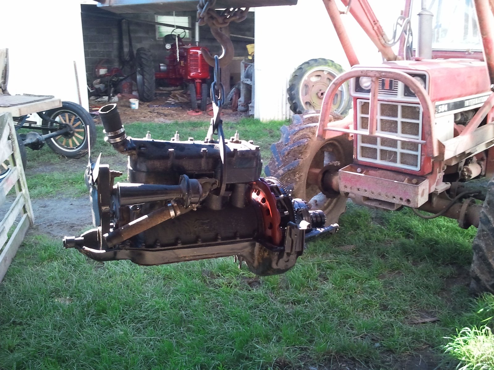

Does anyone else use a clamping system like this? Not sure where it originates from as it was borrowed from a since deceased friend, but seems to work well enough and balanced ok when clamped around number 3 cylinder, but have only used it with firewall removed so could do a straight lift/lower.

Re: Removal of an Engine With an Aluminum Head
Post by Kaiser » Sat Dec 23, 2023 5:06 am
The lifting prongs were used on the assembly line in the Ford factory, several old films show them in use and there are lots of old photos of old workshops where you can see them.
The prongs are even in the Ford model T Bible i believe.
They are a very quick way to hoist the engine, but the eyebolts in the plughole are a very safe way to do the job.

The easiest way is to just choke a nylon sling under the oil pan and cinch it between #3 and #4. If you need more tilt, move it closer to #3.
