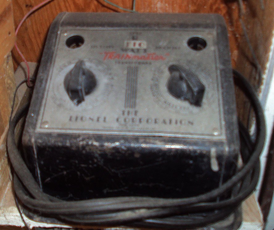

I can't help but you have struck a nerve. Several friends had Marx, and they were wonderful back then. This has nothing to do with Marx but is from the same era.
Thanks for reminding me of those wonderful times.
