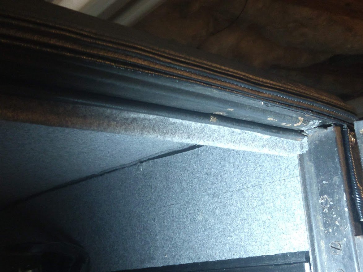

Hi Gary,
I've been finishing the interior on the 27 Tudor and got the doorway seal piece finished. The "V" piece of metal has material from the interior (cloth) wrapped around it. The seal is a piece of leather-looking welting tucked into the "V" metal strip which is pushed up on to the steel rib of the body in the door opening. I used my original piece of welting which is not in great condition, but it works for now. If it bothers me, I may change it out later. Note that there is a small metal clip on the "V" piece and this is where the door bumper hits. I guess this was there so as not to wear away the cloth. Here are some pictures as promised:
The "V" metal piece with the seal attached: The "V" metal piece in the doorway: The small metal clip: I hope this helps!
John
John
