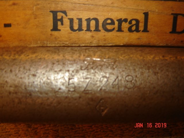

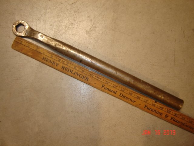

Here is the wrench that Ford supplied for the job when our Model T's were new.
This is an original 5Z-248 rear axle Ford wrench. It has a 21 inch long heavy pipe handle.
I have never used it, because i'm afraid I would strip the axle or nut.

So, if my calculations are anywhere near correct, using this wrench, a person would need to push with just over 45 lb. of pressure on the end of the wrench, to get 70 lb/ft of torque on the axle nut. Seems logical. But, if a person really leaned on the wrench, with his body weight, you could get well over 100 lb/ft torque. I'm still confused. I think I will shoot for the 70 - 100 lb/ft zone and to the next castlelation for the cotter pin. Sure don't want that nut loose.
Thanks for the photo. I didn't know Ford had a special wrench for the axle nuts.
