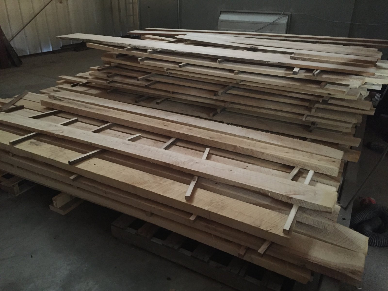

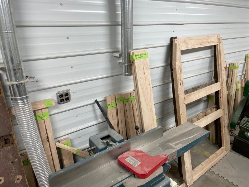

I have a complete wood shop in my restoration shop where we fabricate the wood for bodies that we are restoring. We predominantly use Ash, Hard Maple, & White Oak, -although the factory prints also list other species as suitable for use of these pieces. We generally go thru about 2000 board foot annually, and I generally purchase about third of it in ⁶⁄₄ thickness, about a fourth of the remaining in ¹²⁄₄, and the remaining (-along with smaller pieces in ⁸⁄₄ thicknesses. Maybe that will give you some idea as how to saw it. Much of what we do is glue-up pieces to rough-in the shape of the piece we are fabricating as a way to save material.
Because the Ash Borer has been prevalent in our area for years, we cannot always be that picky, and generally the Miller can tell if it will be ok to saw. It may has some small black spots on the wood from the Borer, however we can usually work around those spots. Because we steam some pieces, we air dry our lumber down to around 18% or less. Below are some pix of my wood pile, and some ongoing projects...
