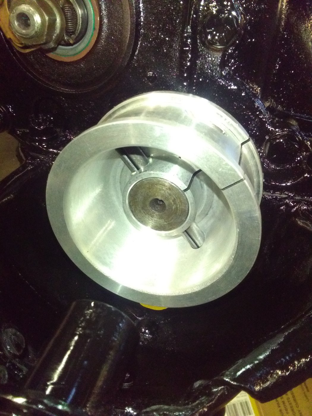

Does your pulley look like this? This pin is positioned correctly to engage the ratchet properly.
Yes, the roll pins can be difficult to install, but reshaping them to reduce the diameter when the crankshaft hole is not worn helps quite a lot. They can be squashed in a vise along the length to do this as needed.
Loosening the clamp screw or removing it completely for installation may also make slipping it on the crankshaft easier. Additionally, a beat up pin hole often times creates a substantial burr on the edges of the hole that should be filed down smooth.

Dan, I just received a couple of the pulleys in question:
The ratchet teeth if you will, cannot not wrap around the pin, the ratchet hits the back of the pulley wall first, so not enough clearance for the teeth to catch to pin. I tried new crank ratchets, old worn, none will allow the teeth wrap around the pin to prevent slipping when hand cranking.
