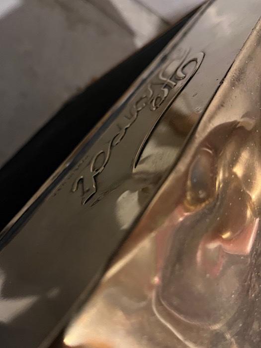

Here are some pictures. I shouldn’t have done such a good job polishing; it makes the dents harder to see but you get the idea. It’s not a horrible dent, but it is visible, right in front for all to see!

And yes, my radiator doesn’t leak or overheat.

Your radiator has been re-cored some time in it's life, the top tank is not easy to pull apart, they are seam rolled together, look around for a good top tank and get a radiator service to transplant.

I am going to step on a few toes here.
One does not really "remove" the top tank from a brass era radiator. One must "disassemble" the top tank from the radiator.
And when putting it back on, again it is assembled onto the radiator.
First off, and last on is the back piece (under the hood) or panel above the water inlet. With that off, you "might" be able to straighten and re-solder the front and top pieces, working from inside the top tank.
However, that front panel is bad enough that it would be much easier to repair (and make it look nice!) if it were removed from the radiator. It may be a judgement call whether the extra work to remove and reinstall it is worth the effort saved in making it look nice. I straightened my dented radiator from inside without removing that piece and it came out better than I expected it to. But mine wasn't dented as badly as yours.
The way the top/outer piece of the top tank is intertwined with the side pieces? IF (big IF) those parts are not broken or in bad shape, it may be easier to keep the top/outer piece in place. You should be able to remove the front panel (with the "Ford" script) while leaving the top/outer piece in place. It is a bit tricky to unsolder and put back into place that way, but I have done it.
One of the radiators I repaired the "intertwining" between the top and side pieces was badly broken apart. That one I had to completely disassemble and make repairs. It looks good now, and holds water.
The water inlet on brass era radiators is an odd little piece that varies a lot depending on whether it is a real original, or a half century old reproduction, and who built it?
Some of those water inlets are cast brass (nice!). Most appear to be cast iron or steel. Whether they can be repaired or not depends upon the quality of the cast steel or iron, and just how much or little remains of it. So far, my luck with those has been good. Even a couple that were in terrible condition had a good enough quality of steel that they would accept and hold brazing. One, the place where the radiator hose goes, was completely GONE! I slightly resized a scrap of steel waterpipe, and brazed it into place with some gussets I made from small steel scraps. The heat from all that torch work thoroughly cleaned the remaining original metal and my new areas. I then coated it inside and out (except for where the soldering attachment is done to the top tank!!!) with a high strength epoxy to slow down future rust eating away the remaining original areas.
Pre-tin everything before assembly to make soldering easier.

I have an idea that has not been proven but just a thought. I have had a "paintless dent removal" done to several dents on my original 1988 Mustang 5.0. I was amazed with the result. If in this case of the radiator, would it be possible to open a one inch hole in the back of the tank so the rods used by the professional could access the dents from behind. Once the work is done, one could solder a plug into the hole and smoothed and then painted.This may be me over thinking!!!

The dents shown show some stretching of the brass panels. Re-working and shrinking them would require considerable skill, considering that the panels are flat and will again polished.
It would be far simpler to replace them with good donor panels. The panels will need to be removed to work on them, so replacing them with straight replacements will save the time and expense trying to repair the originals.
Either way, it is not a job I would take on myself. Find a professional used to working on old car stuff.

DickC wrote: ↑Fri Jan 26, 2024 7:38 pmI have an idea that has not been proven but just a thought. I have had a "paintless dent removal" done to several dents on my original 1988 Mustang 5.0. I was amazed with the result. If in this case of the radiator, would it be possible to open a one inch hole in the back of the tank so the rods used by the professional could access the dents from behind. Once the work is done, one could solder a plug into the hole and smoothed and then painted.This may be me over thinking!!!
I have used this method for repairing many things, and it can be very effective. However as Allan has just pointed out, in this case the damage is serious enough that the pieces will at the least need backing up and shrinking more than the small push from the inside can provide.
It also needs to be pointed out (I meant to say this earlier but forgot!), that brass, especially old brass, should be annealed before any significant bending or hammering is done. There is a perfect temperature where the color of the brass begins to change SLIGHTLY. It takes some practice to get good at it. However, be very careful, just a few degrees too hot and the brass will suddenly turn into a puddle! (If you think annealing brass is difficult, you should (shouldn't?) try welding thin brass. I have welded nearly a hundred cracks in brass headlamp rims. That is really tricky to get right. A few degrees too cool and no weld. Just a couple degrees too hot, and a small area turns into a puddle alongside a big hole to be filled in!
Brass "work hardens" every time you hit it with a small hammer (or anything else!), or bend it even slightly. Work harden it enough, and the next move you make will result in a crack that will need to be welded.
The brass should be annealed again and again as needed. "As needed" is a judgement call that takes practice to get the right feeling for it.
Most people silver solder cracks in brass, with good results. I have done that also. I taught myself how to weld brass when I didn't have any silver solder handy and the local welding supply was out of it. I liked the results from welding the headlamp rims and have done so several times since.

Re: Brass Radiator repair questions
Looks like a good sullution has been found. I was thinking of the paintless dent removal while reading this but agree that it might not work in this case or could be too expensive. Knowing Bill, he would rather save the original top but original replacement top is good too.
