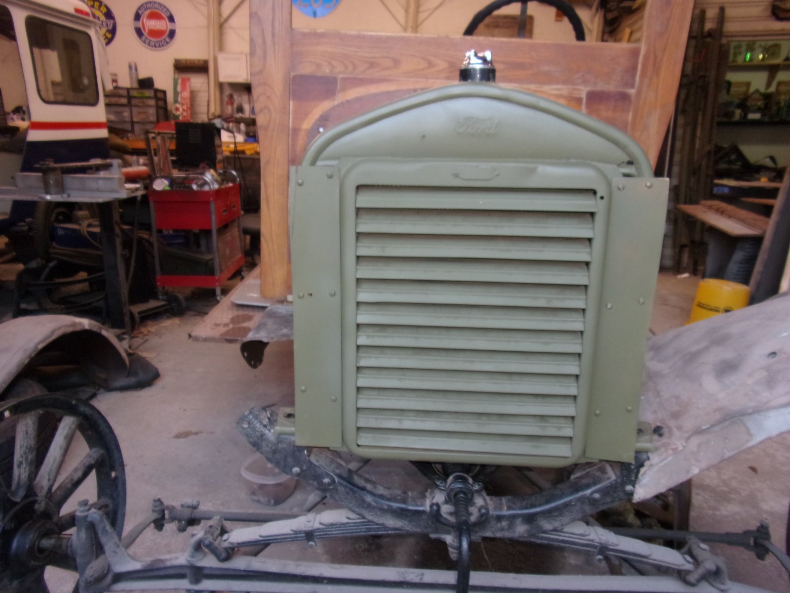

Sorry for monopolizing the forum lately, but there is wisdom in the masses. So, I messed up and it's not a deal breaker, but wondering if I can cobble something up or if there are some other options to bail me out. Installed shutter on front of radiator grill because I had one is tock and I think it looks very military for my WWI ambulance project. Got it all loosely installed and a rod to the cab to operate the shutters from inside the cab. I'm tickled pink in the looks of it.
But, then reality hits home when I go to crank start it and rip open all four fingers of my right hand when the crank handle hits the bottom of the shutter. I've got electric start,, but it's a nice show and tell to hand crank it. I need at least 2" in hight and if I reinstall the shutter and wings hight enough, it will cover up half the Ford script and I'm not in love with that option. Feels like I only need about 1/2" forward to clear the shutter, so if there is any way to lengthen the part of the crank that holds the pin and special female end that grabs the crank nut, that would be a fix.
Don't know if any vendor make an extended crank or if a crank from another model car might work? I would think welding on a 1" or so of rod to the tip would be under a lot of torque and stress.
Any thoughts? Other than I'm an idiot for not checking the fit prior to brain farting.

A quick fix you could heat the crank handle by first bend, straightening it out, then bend again an inch or so forward.

Joe is on to something but 1" off the handle is a rather large loss of leverage. maybe just put a 15 degree bend @ the engine end & 15 degree
bend @ the handle end that will move the handle out about a inch & only shorten the throw about a quarter of a inch.

Wow! Great responses. Some I had going around in my mind and some were not. If I were to cut and weld in a splice, it would be on the "inner" straight rod and I would have to clock the holes. But the bending is an option that I want to try first. I have several old cranks and it was suggested by a forum member that just opening up the two bends about 5 degrees each would allow the crank to clear the shutter. The handle is not an issue, but bending the inner bend to clear the shutter would cause the handle to be at an upward angle. So opening up the outer bend would bring it back to parallel.
I'm gonna heat one up and see if I can open up the two bends and report back.

I've got the crank in the vise waiting for my son to come home from work and help me heat up and bend. But, we do have a pipe bender, so we will look at that option as well. The pipe bender will allow us to mark before and after bends. I also have a decent parts crank that I could cut a 4" or so section off of and cut off a 3" or so section off the current crank and weld the replacement, longer section on and I'd be a single weld 1" long, no holes to drill fix. I like the idea of possibly using a crank bushing as a sleeve over the weld and weld the sleeve in place and use it as the bushing in the nose clamp.
But, I will try the bending first.

After action report, as promised. Put the crank on the pipe bender and opened up both bends. Pic is next to original crank. Probably opened up more than we needed to, but after installation, certainly clears the shutter and pops off after start. Perfect solution, no welding, drilling, clocking, etc.
