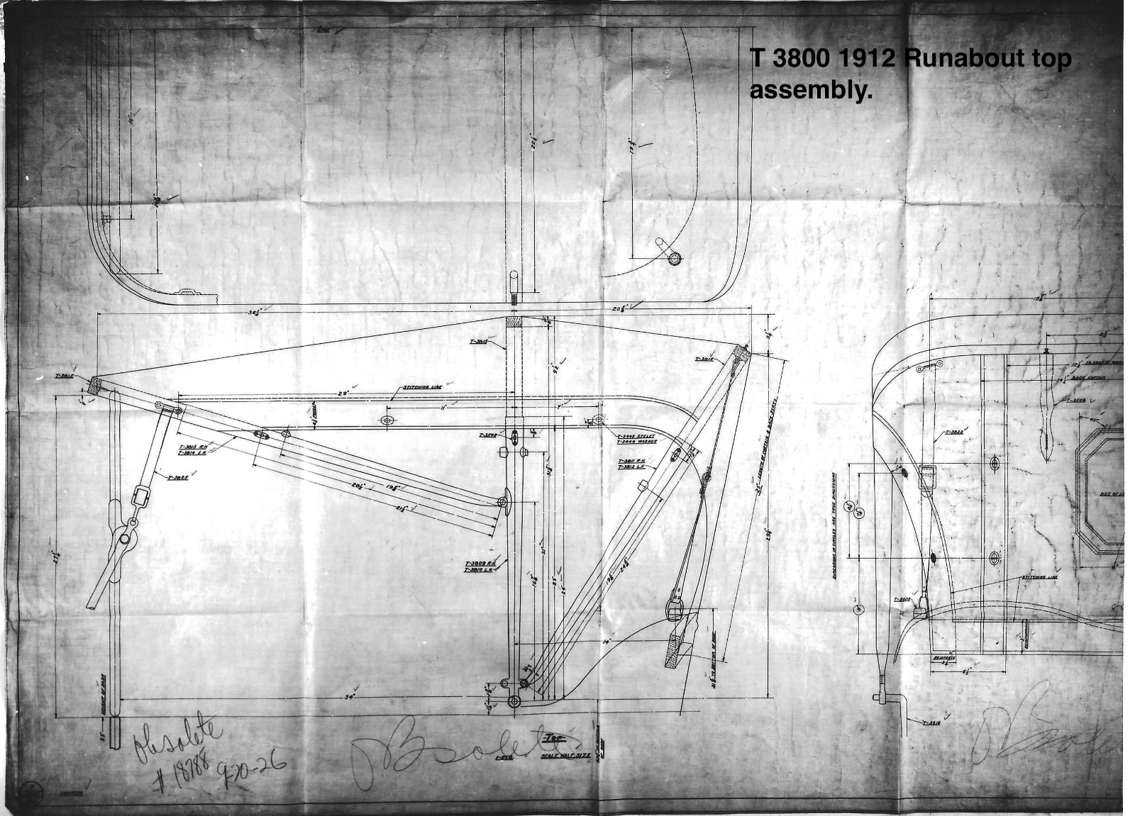

Here is scan factory layout of a '12 runabout top.
Scan size is all that is avail. If you have zoom on a pc, shows up fairly well.
Click on image to enlarge.
