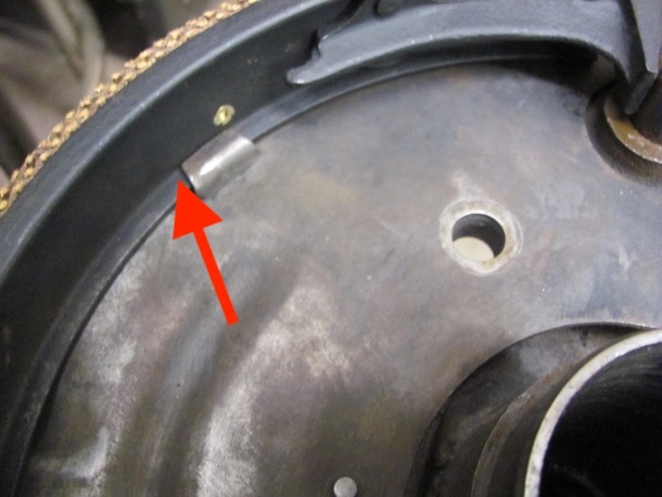

Post by DanTreace » Mon Feb 19, 2024 2:34 pm
Sometimes the leading edge of the lining needs to be tapered, by grinding off some, if it stands up too much.
100_1204 (550x367).jpg (62.44 KiB) Viewed 2497 times
And be sure the shoe edge is tucked under the 4 retaining tabs to keep it close to the backing plate.
